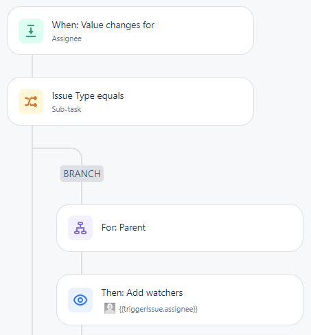

How to create this automation for adding assignee of sub-task as a watcher to isse?
Samrudhi Shete September 9, 2024
Whenever a sub-task is assigned to someone, they should be added as a watcher to the regular issue that the sub-task is a part of.

Hi @Samrudhi Shete, to copy the Assignee from the Trigger issue to the Watchers list of the Parent, you should try the "Add watchers" action with the smart value: {{triggerIssue.assignee}}.
Hope this helps,
Kel
Samrudhi Shete September 10, 2024
Thank you! @Kelly Arrey , It's working!

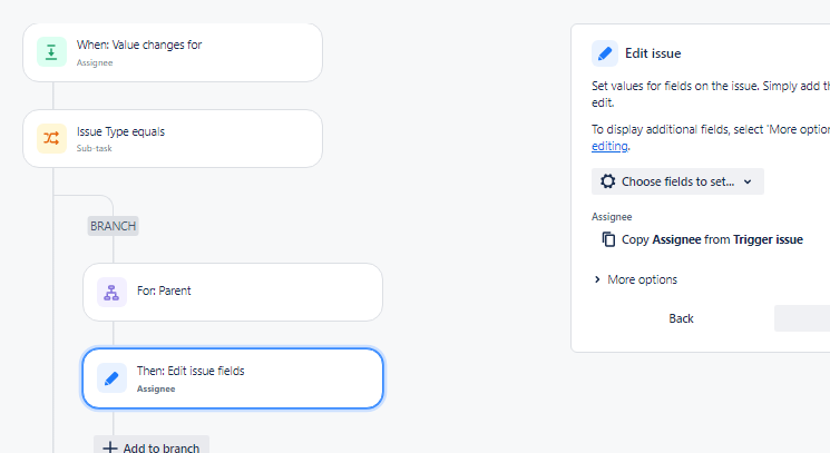

Hi @Samrudhi Shete ,
You can create an automation similar like below:
