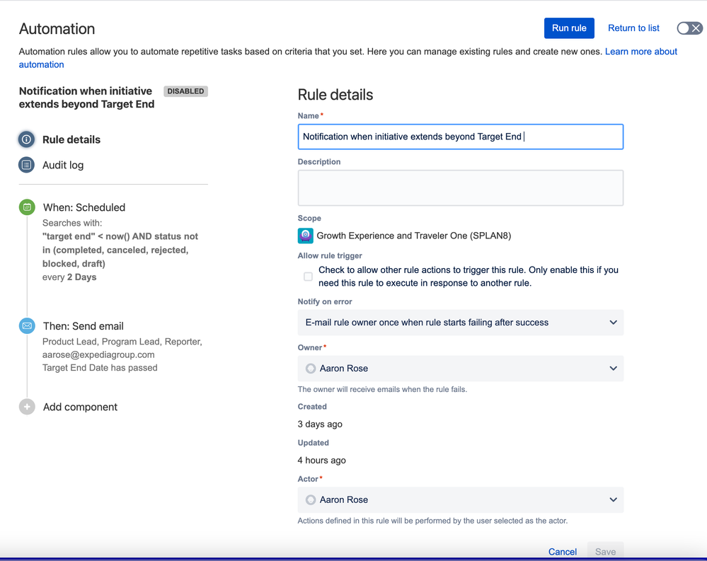

I have this rule setup to notify Product Managers when an initiative goes past due. But the notification email I send does not include a link to the initiative. I'm assuming I need to include some smart values in the email template but I cant quite find the solution. Has anyone solved this yet?

Hi @Aaron Rose --
You'll need to use a tiny bit of HTML with smart values, so like:
The Target End Date has passed for the following issue:
<a href="{{issue.url}}">{{issue.key}}</a>

Aaron Rose July 24, 2023
@Darryl Lee Worked perfectly! Thank you.
I added a comma and the issue summary using this:
<a href="{{issue.url}}">{{issue.key}}, {{issue.summary}}</a>
