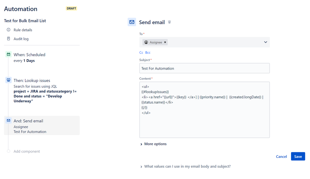

Looking for an automation rule to send out an email that specifies
  1. How many issues are done on the Project
  2. How many issues are in progress on the Project
3 votes
John Funk
September 27, 2022
Hi Max,
You can create an Automation Rule like below using the #lookupIssues functionality.

Hi @Max Haley ,
I would suggest to Create filters and add subscription to them.
https://www.atlassian.com/blog/jira-software/jql-the-most-flexible-way-to-search-jira-3-of-4
Max Haley
September 27, 2022
Thanks, this is pretty neat its just I can customise the "From" sender by using email automation. I wonder if I can create a filter, and then devise the same email be triggered automatically via automation?
