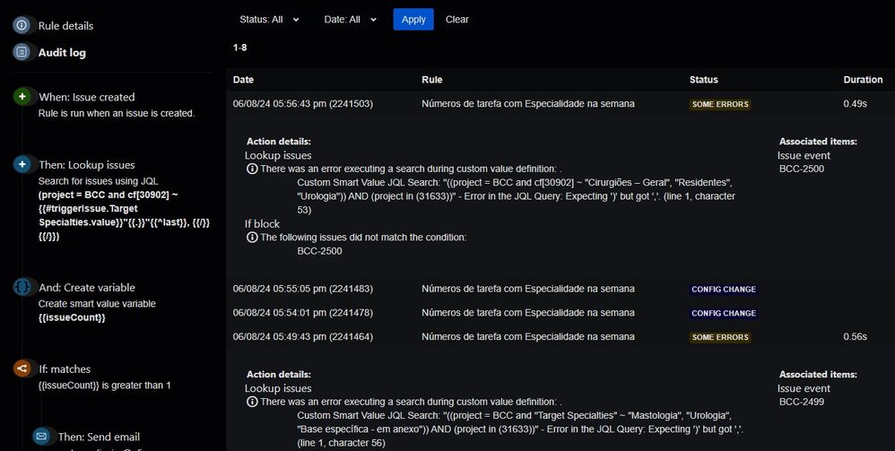

Thank you so much for your help, as always! In the automation log, I can see it did iterate through the values of the trigger issue and brought them together. I assume that, despite having multiple values in what looks like a string, it's used by the automation as an array with multiple values, right..?
But now, for some reason, I can't pass the lookup size to the smart variable... Would you know what could be the problem?
I'm under the impression the lookup was successful (since the log passed through it), but maybe it's not saving the number of issues found - or maybe it did not find any issues, when I'm sure they exist..?
You'll see I tried both the field name and also the cf[id], but none of them worked - at least, not in the lookup side... any of them works fine to get the trigger Issue values.

Looking at the audit log, the JQL is not correct.
Is your custom field cf[30902] a multiple-select option field?
If so, please try the IN syntax and not the CONTAINS ~ one:
project = BCC AND cf[30902] IN ( {{#triggerIssue.Target Specialties.value}}"{{.}}"{{^last}}, {{/}}{{/}} )

Thank you Bill!
I'm sorry, I haven't realized that the SQL needed adjustments in addition to the Smart Values iteration. But now, that worked flawlessly!
