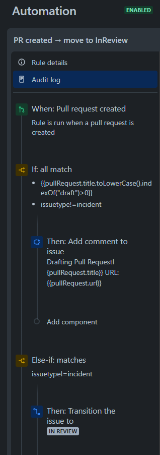

I would like to have automation when a pull request is created, the status is changed to "In Review". However, that should not happen if it's only draft pull request. It can be identified with a pull request title containing "Draft". I also exclude tickets of type "Incident" which have a different workflow.
No add-on tool possible.
The following automation rule returns "some errors" but only details "no actions were performed". Can someone please help me?

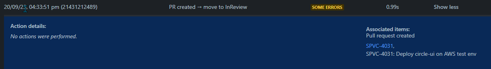

Nicolas Courvoisier September 21, 2023
Hello @Bill Sheboy
There is nothing more for the rule at the bottom of screen.
Thank you, best regards

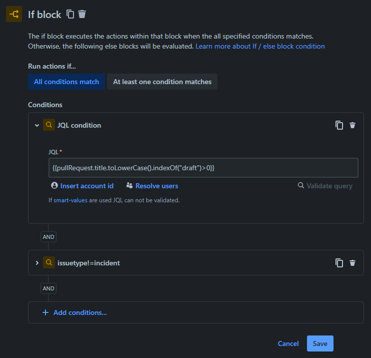

Bill Sheboy
September 21, 2023 edited
Thanks for that information...and I am fairly confident your conditions may be the problem.  If you post images of your condition details I can confirm that.
What you show leads me to believe you have this in a condition:
{{pullRequest.title.toLowerCase().indexOf("draft")>0}}
That is invalid, as the greater-than sign is not valid in that expression.
There are at least 2 ways to test that condition:
  • use an advanced compare condition and test
    • first value: {{pullRequest.title.toLowerCase().indexOf("draft")}}
    • condition: greater than
    • second value: -1
  • use an advanced compare condition, with an inline, greater-than test
    • first value: {{pullRequest.title.toLowerCase().indexOf("draft").gt(-1)}}
    • condition: equals
    • second value: true

Hello
Please find below my condition, I used indeed a simple "JQL condition":
I switched to "Advanced compare condition" with your 1st change:
  • second value: 0
and am waiting for the next PR created. I keep you posted. Many thanks.

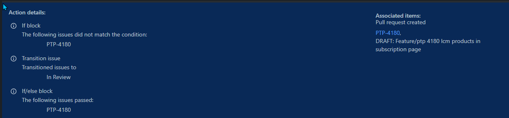

Unfortunately, the positive match condition with the PR title did not work. This couldn't be tested previously (requires a PR with "draft" in title).
As you can see PR contains the word "DRAFT" but the if condition isn't matched.
Any idea? Thank you
Bill Sheboy
September 28, 2023
My apologies, Nicolas...It appears indexOf() returns a 0-based value.  That is, the first position is at 0.  When nothing is found, it returns -1.
And so the second value in that condition should be changed to -1 to help when draft is in the first position.
I will update the earlier posts also.
