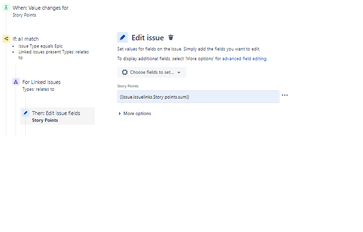

I need to update the story point of an "Initiative" as the sum of the "linked" epics. So epics are linked to the initiative (not as a subtask but as a link). Whenever the story point of the epics change, the change should get reflected in the way that the sum of story points of all the linked epics should be = story point of the initiative
1. When: the value of story points changes
2. If the issue type is epic and there are linked issues
3. For the linked issues (which means the for initiative}
Story point = {{issue.issuelinks.Story Point.sum}}
However, this is not working. The story point for the initiative is zero even when the story point for epic has values

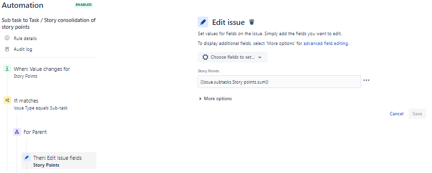

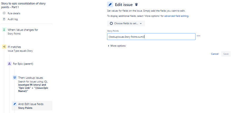

Thanks, so finally these rules worked.
Now I am able to sum subtasks to 1. user stories/task level, then another rule to go from 2. user story to epic level and then one from 3. epic to initiative (linked, not through hierarchy)
These rules are working very well individually, but are not working together, so when #1 runs, the #2 doesn't get triggered automatically even if story points are getting changed at a story level. But when I manually change the story points of the user story, the #2 works.
Ideally since the trigger is change of story points, the rules should run whether the change is done manually or by another automation rule . Could you please help?

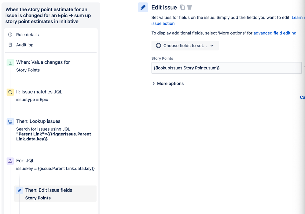

For those who are interested. We created a video tutorial here: https://community.atlassian.com/t5/Automation-articles/Jira-Automation-Sum-Up-Story-Points-from-Epics-e-g-Initiative-gt/ba-p/1926311

There are no errors, the rule is successful, but the sum is not happening, the story point value is 0
See rule below:

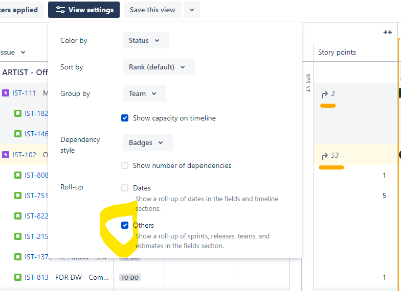

As, using the "Parent link" field with an Advanced Roadmap plan and Story points "rolled-up" feature enabled means you can get the affect of "summing", without the need to automate at all.
See below "Roll-up" checkbox to tick and Story points column with "rolled-up" story points from the children (denoted by the up arrow)
In that case I have to wonder if it would make may sense to change tack and make children of the Initiative??
If these Epics are so crucial to this initiative that you want to derive its Story point total, then surely they should be hierarchically linked (using the Parent link field).
This would be playing to Jira's strengths and would enable not only the story point summing you desire, but also better, more logical and easier to create and maintain views in Advanced roadmaps. It would also make writing your automation rule easier.
May I also ask, if these Epics are not the children of the Initiative, then which ones are? and how do they differ to these ones? Why would they not all be part of the Initiatives hierarchy?

Thanks for the image of your rule. I believe that {{issue.issuelinks}} only contains the keys and not the rest of the data (such as story points). You could confirm this by writing the following to the log in that branch to learn if any values are shown:
{{#issue.issuelinks}} {{Story points}} {{/}}
And even if that did work, your branch's scope would be updating the story points of the epics. You would then need to accumulate the values for the epics to store a total in the initiative.
Thanks, How should I do the sum ?
{{#issue.issuelinks}} {{Story points}} {{/}.sum} ?

{{#issue.issuelinks}} {{Story points}} {{/}} is not working. There are no errors but the story point field is updated to "None" instead of the actual value

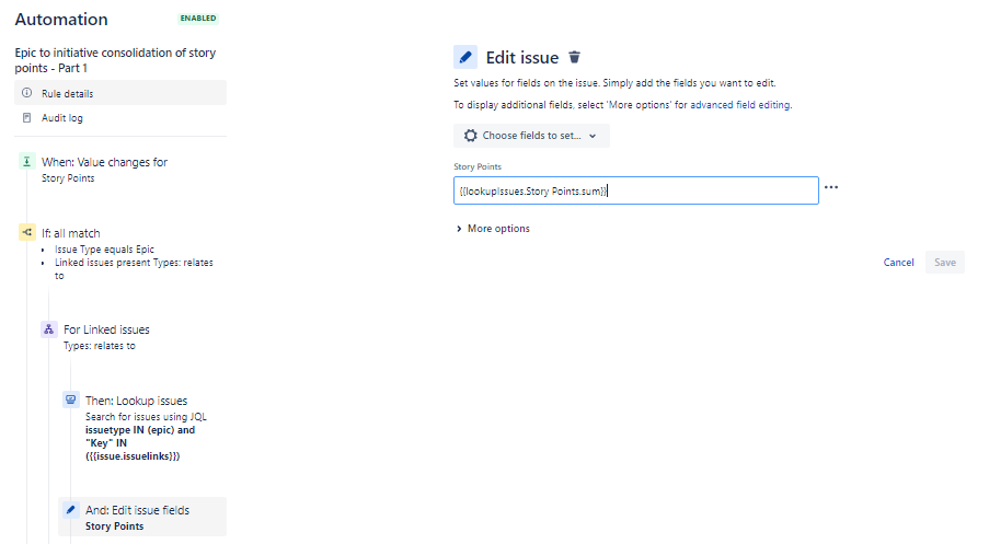

Thanks for that information. That means the issue links only contain the keys, as I suggested. To sum up the story points for linked issues you may to use another method, such as Lookup Issues with JQL on the list of issue link keys:
key IN ( {{#issue.issuelinks}} {{key}} {{^last}} , {{/}} {{/}} )With that for the lookup's JQL, you may get the sum from:
{{lookupIssues.Story points.sum}}
Ideally, since the trigger is change of story points, the rules should run whether the change is done manually or by another automation rule . Could you please help?
Just to also clarify, when i run the subtasks rule, the #2 and #3 rule logs say that only the user story points of the subtask has changed, it doesn't even take into account the story point change for the user story using the automation rule when #1 runs
When your use case requires a change made by rule #1 to trigger another rule (e.g. rule #2), look in the details section of rule #2 and enable "Allow Rule Trigger". This is disabled by default to prevent a looping/runaway situation in rule execution.
