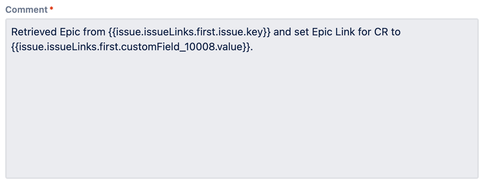

Retrieved Epic from {{issue.issueLinks.first.issue.key}} and set Epic Link for CR to {{issue.issueLinks.first.customField_10008.value}}.
This partly works, the issue key is returned correctly but the customField_10008 value is returned as "". I've tried capturing values from other customFields with the same result.

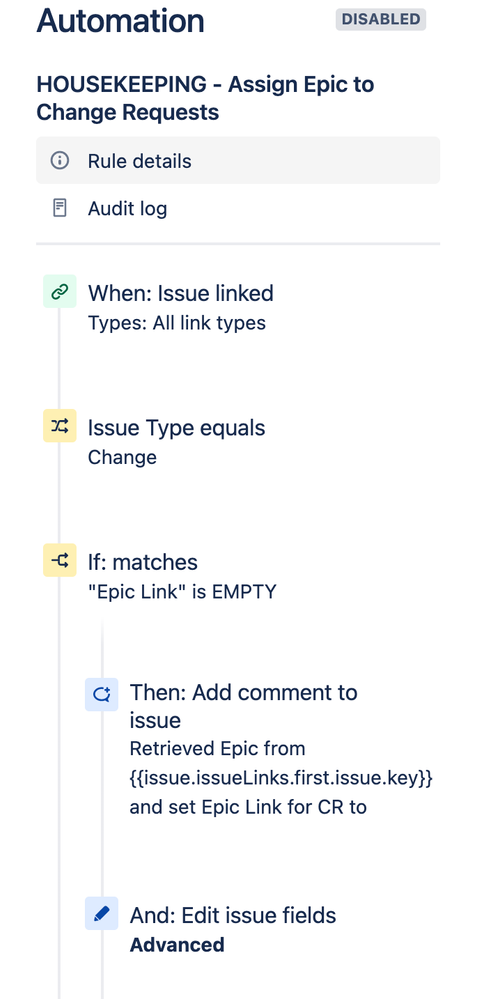

Hi @Patrick Booth and welcome to the community!
Can you please provide a screenshot of the rule so we can gain additional context on the issue?

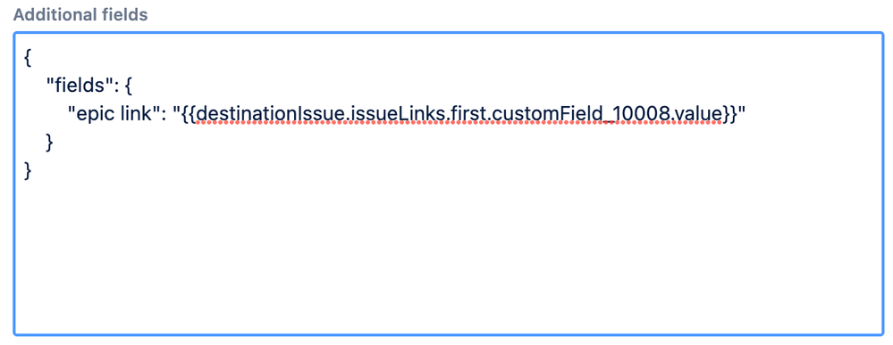

@Mark Segall
I had a quick look at using destinationIssue as you suggested but Jira returns invalid JSON as indicated by the red underlining in the editor. Maybe I've misunderstood how it should be implemented?

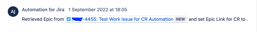

However, I don't believe this is the issue. My existing code is finding the right Linked issue. I have proven that by posting a comment in the Change Issue triggering the rule with the issue ID from the Linked Issue.
Result:
As you can see it's returning the issue key, this is the correct one and what is expected, however, the value for the Custom Field is coming back as an empty string. The same applies for other attributes such as name or ID, and with other Custom Fields.

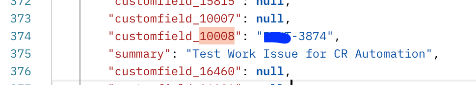

Note: The custom field reference is correct and the Epic Link Issue Key is populated in the Linked Issue XXXX-4455. Verified via an API request from Postman:
