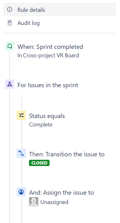

I'm hoping someone can help as I've tried troubleshooting and just can't figure out why a couple of the Jira automation rules which were running fine, stopped working about 3 weeks ago.
Both rules run across Multiple Projects and are triggered by either a Sprint started or completed event.
The only change which was made to these rules a few days before they were due to trigger was that an additional project was added to the list, but the same was added to 3 other rules (which are not triggered by sprint events but rather issue transitions) and they're still working fine.
Audit logs don't show the rules triggering at all, last activity is that edits were made (when I added the extra project).

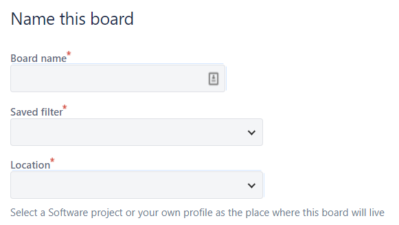

- To facilitate this, rather than make yet another project, a multi-project board was created filtering all the projects' issues, and linked to a user, not a project. ('Location' setting)
- Since sprints are managed from this multi-project board, the sprint-specific automation rules are set to check that board for changes

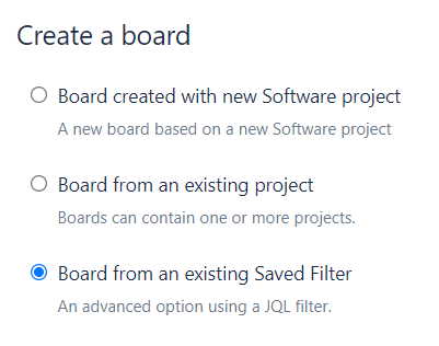

To further elaborate: on creating a new board, if you pick the last option "Board from an existing Saved Filter", on the next screen you get the option of setting the Location to your own personal profile instead of a project - you just start typing the profile name and it'll come up.
This is the specific scenario that's failing now.
Automation rules, supposed to be triggered by Sprints which are running from a board linked to a user profile (not a project), aren't being triggered.
