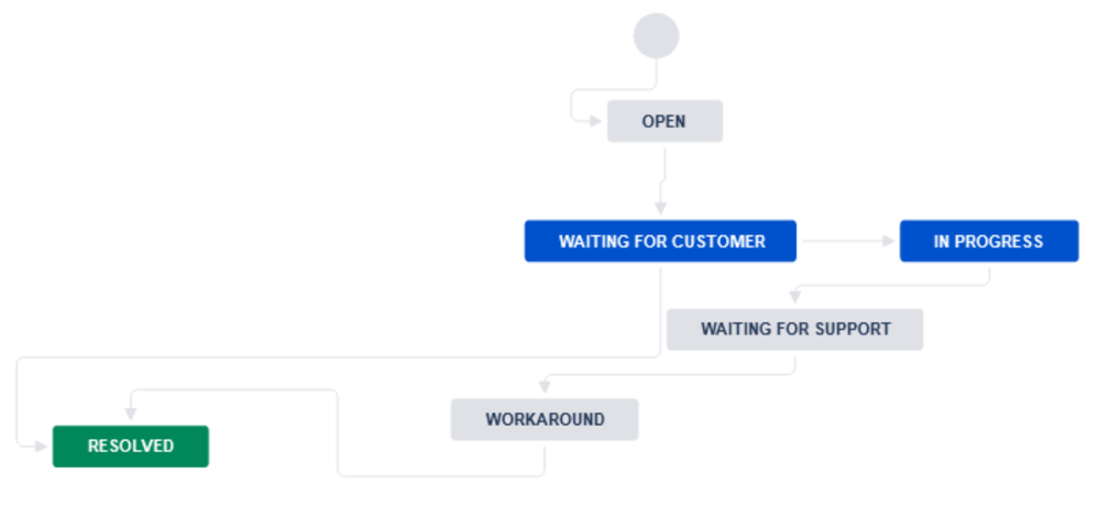

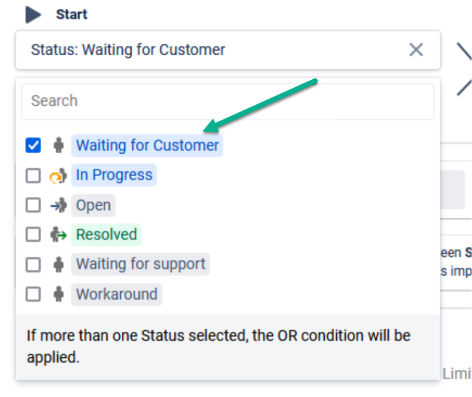

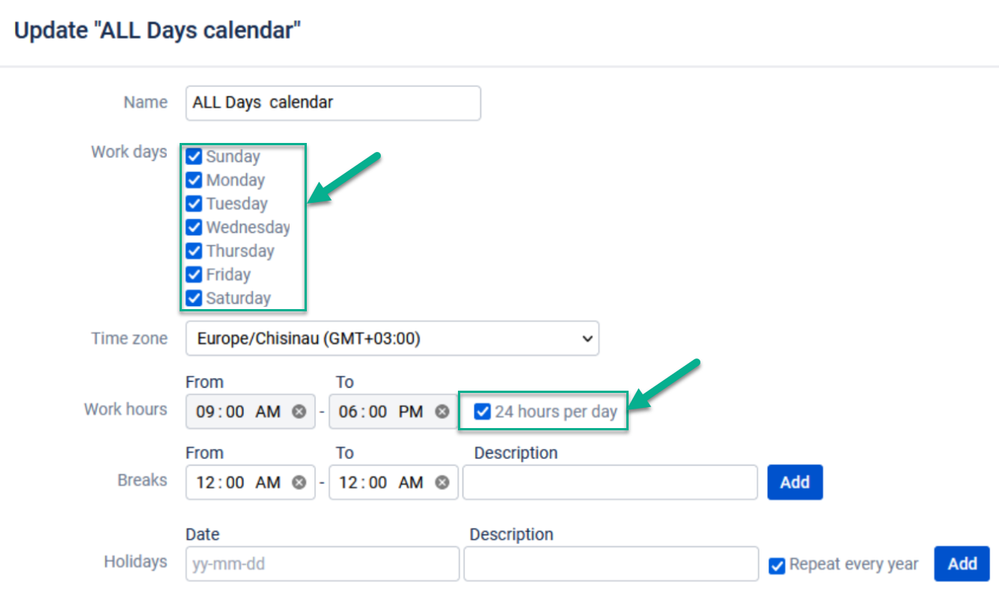

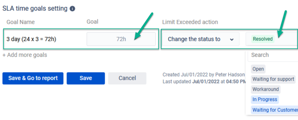

I’ll try to help you. If you want a rule where an issue is automatically closed after it has a specific status for a set number of days, you can install plugins that offer such an opportunity. For example, SLA Time and Report for Jira add-on and do the following steps:
Set status change to Resolved
Don’t forget to check your workflow.
You need to have the ability to move to Resolved if this status was chosen.
Create a task and change status to Waiting for customer
Wait until your time goal happens.
After 72 hours the status will be changed automatically.
I hope this is what you need.
