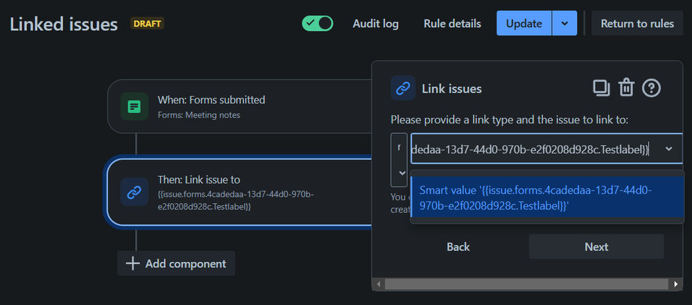

I started small with testing linking just one issue. I tried the following:
{{issue.forms.4cadedaa-13d7-44d0-970b-e2f0208d928c.Testlabel}}

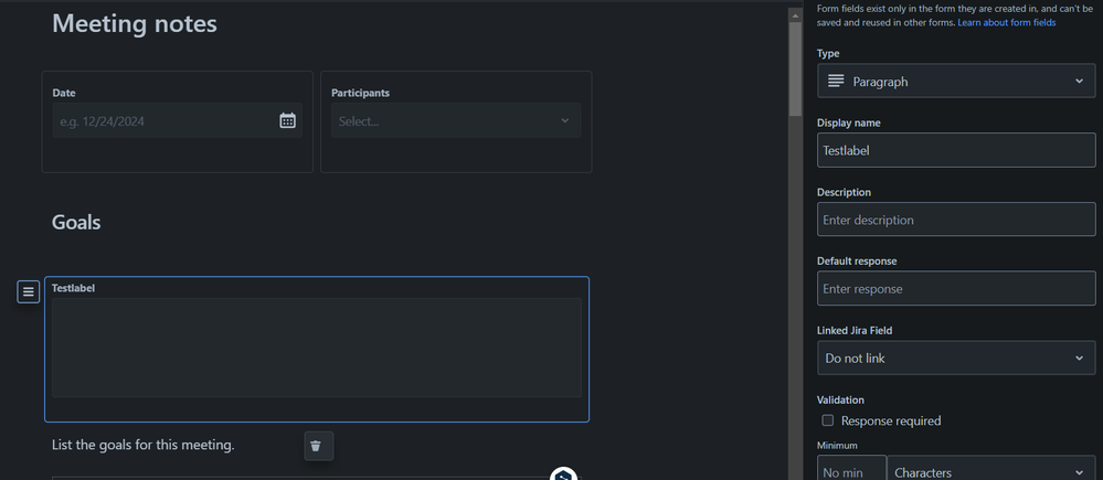

4cadedaa-13d7-44d0-970b-e2f0208d928c is the UUID for the Meeting Notes form (just a test form I created). I retrieved as per the instructions here.
Testlabel is the name of the label in my form:
However, the rule failed, whether I added the issue key or the full link when submitting.
I also tried {{issue.forms.4cadedaa-13d7-44d0-970b-e2f0208d928c.Testlabel.distinct}} and {{issue.forms.4cadedaa-13d7-44d0-970b-e2f0208d928c.Testlabel.key}} but that did not work either.
Any idea of how I am doing this wrong?

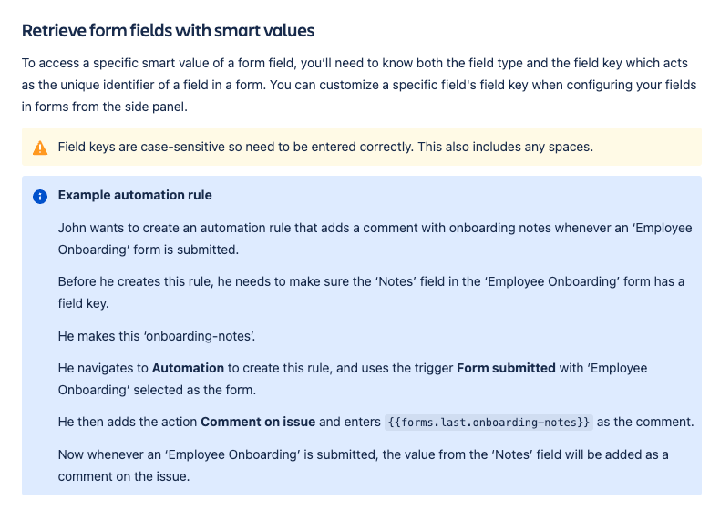

From the documentation

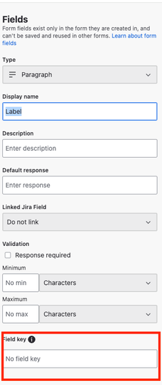

Fields in forms need to be referenced by their Field Key. You need to set the Field Key for each field that you add.
What is the Field Key for your field? The screen image you shared doesn't include the red-boxed portion that would show the field key.

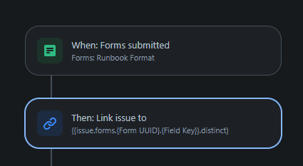

@Trudy Claspill Thank you! I was missing the Field Key indeed and using the Display Name. Fixing that solved the issue.
Final query had this format:
{{issue.forms.{Form UUID}.{Field Key}}.distinct}
I activated the automation and now when filling in the Issue Keys separated by commas in the correct form field, they are now linked automatically when I submit the form, just like I needed.
