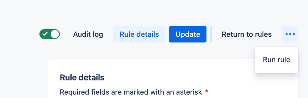

The scheduled trigger does have a "Run rule" under the ... menu at the top-right, after the rule is published in the editor.  There isn't a "run now" option in the rule list.  Is that what you meant?
Manually triggered rules are always from the context of an issue, even if they do not use it.  And so "run now" would not work without supplying an issue.  You could change the trigger to Scheduled to allow run-now from the editor.

Sean Saxon August 12, 2024
Image of the "Run Rule" button, which is the equivalent of "Run Now"
