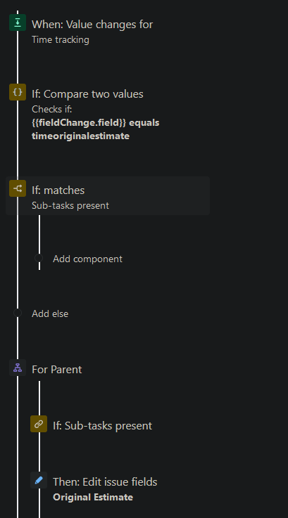

Does this look right?:)

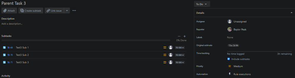

So what is happening when this rule is triggered, it is summing all subtasks in my project....
My test Parent is set to 0m for Original Estimate
Then I have 3 sub tasks each
Now, my Parent task is displaying 13w 2d 4h

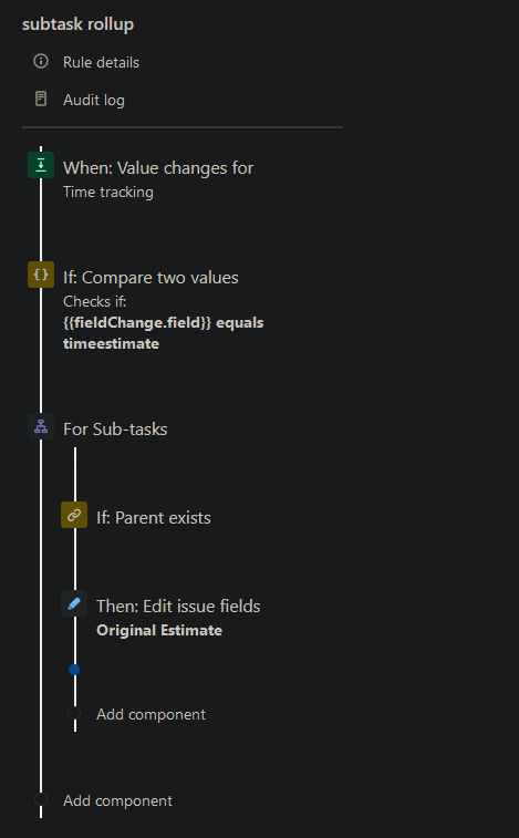

Not quite. For this bullet:
you'd want to use the following (instead of your "For Sub-tasks" branch):
Also, don't forget about this bullet point:
That should be before the branch. This is because you only want to fall into this branch when the triggered issue is a Subtask.
Sorry, this is the part that I'm not getting. I understand the IF logic (IF sub task exist for Parent) but I am confused how to configure it in this system :) :(

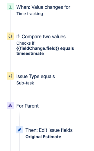

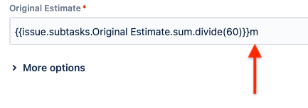

Wow. This was not as trivial as it look originally. I built out a working rule, which looks like this:
But as the thread above shows, the trigger and initial conditional wasn't originally obvious. One last bit of surprise was how the "Edit issue" action needed to be configured:
Note the division by 60, and especially the suffix "m" for minutes.
Internally, Jira stores duration values in seconds. So, we divide by 60 to get minutes, or divide by 3600 to get hours.
Why not just divide by 3600 here and drop the "m"? I tried that first, and the division result was rounded (giving me 8h instead of the expected 8.3h, for example). The documentation doesn't explain this; I might report it as a bug.

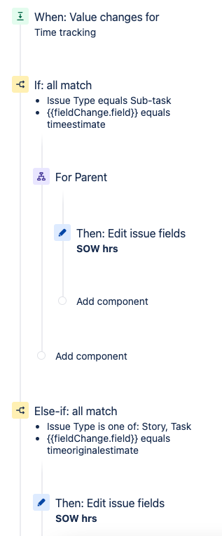

Proceeding with all these assumptions, the rule needs the following changes:
Here's the new computation of the total:
{{#=}}{{issue.subtasks.Original Estimate.sum.plus(issue.Original Estimate)}} / 3600 {{/}}
Note that I've changed this to using a computation {{#=}} total / 3600 {{/}} rather than using the .divide(3600) function. It looks like the function rounds, which I believe is a bug in automation. I'll report that shortly.
Note also that the denominator changed from 60 to 3600. This is to convert minutes to hours.
Here's what the new rule looks like. Note that some of the conditionals have been aggregated for simplicity:
For the two "Edit issue" actions, use the new computation value listed above.

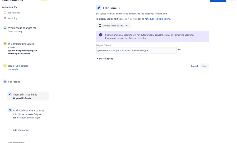

Hello @Mykenna Cepek
I'm looking all over for this solution (sum subtasks original estimates into parent's original estimate field)
I've tried the exact same automatin you suggested above, even changed the default unit for timetracking to make sure all would work the same way...
Well, the parent's original estimate field keeps getting updated with the value 0.
I even added an action of commenting the issue with {{issue.subtasks.Original Estimate.sum.divide(60)}}m, and that only confirms it keeps adding 0 to the original estimate.
Do you have any idea why this might be happening?
Hmm, hard to say for sure with just this information.
Some things to try to discover more about what's happening:
Hope that helps you figure it out!
I'll add to the chorus of grateful people and say thank you @Mykenna Cepek!
I was having trouble with this exact use case and it turns out my automation wasn't working because I had
{{issue.subtask.Original Estimate.sum.divide(60)}}m instead of
Such a small difference but without the 's' on the subtasks, the rule wouldn't run properly!
