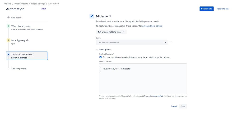

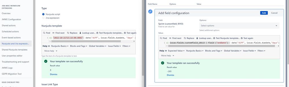

I have tried using both Jira Automation and JMWE to automate this but to no avail. I am unsure if there is a way to do this with these apps ?

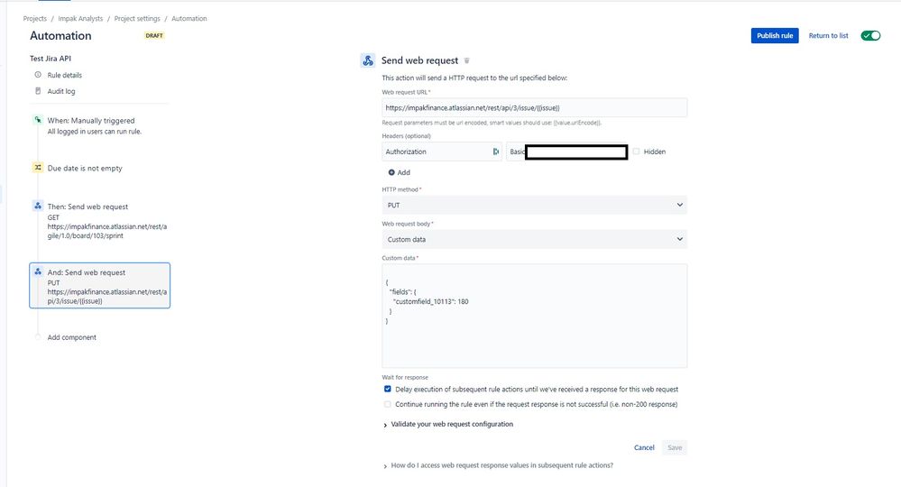

I have managed to configure two web requests with the Rest API.
The first one is a GET that returns all the sprints of my board, as you suggested.
The second one is a PUT that edits the sprint field of my trigger issue.
These two seem to work fine after some back and forth.
However, I still can't seem to find a way to differentiate sprints depending on the due date of the trigger issue. I have tried using the Jira Automation conditions to no avail. I have also tried using the Due Date smart value in the JSON of the web request, but they do not seem compatible.

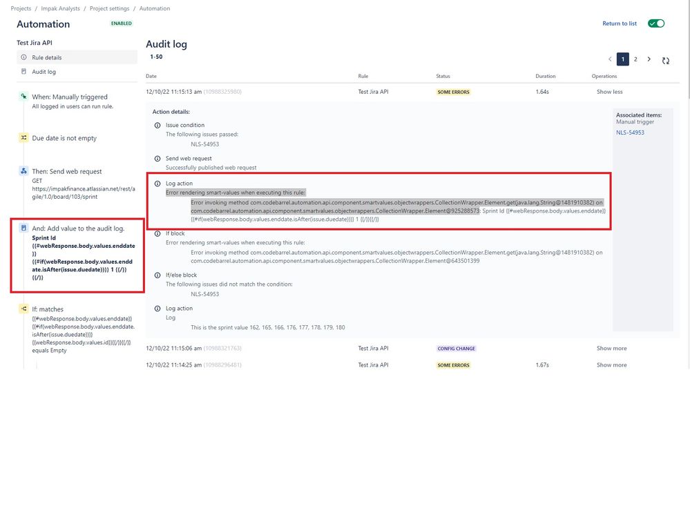

Have been dabbling in this, however every time I seem to have a smart value filter that should work I seem to get this error message:
"Error invoking method com.codebarrel.automation.api.component.smartvalues.objectwrappers.CollectionWrapper.Element.get(java.lang.String@2061000330) on com.codebarrel.automation.api.component.smartvalues.objectwrappers.CollectionWrapper.Element@1007599544:"
I am not sure how to solve it. I have found some similar errors that seem related to the use of plug-ins. This does not seem to apply here as I am using only classic Jira fields ?

Perhaps the structure of the response does not match what you expect. Please first try running that REST API request by just pasting the URL into a browser. Then review the resulting response message to confirm you are getting the correct smart value layout.
UPDATE: After I experimented with this, I do not believe this can work with smart value, list filtering. Sorry for the bad solution idea.
First, the endDate value from the response needs to be converted from Text to a Date type for comparisons, leading to an expression like this:
{{#webResponse.body.values}}{{#if(endDate.toDate.isAfter(issue.duedate))}}{{name}}:{{endDate}}{{/}}{{/}}
Unfortunately...issue fields (and created variables) cannot be used inside of a function, which is inside of an iterator. Atlassian has already marked this defect as "Won't fix": https://codebarrel.atlassian.net/browse/AUT-2430
I also tried other functions instead of isAfter() and they were of no help. The problem seems again related to trying to do this in the filter.
