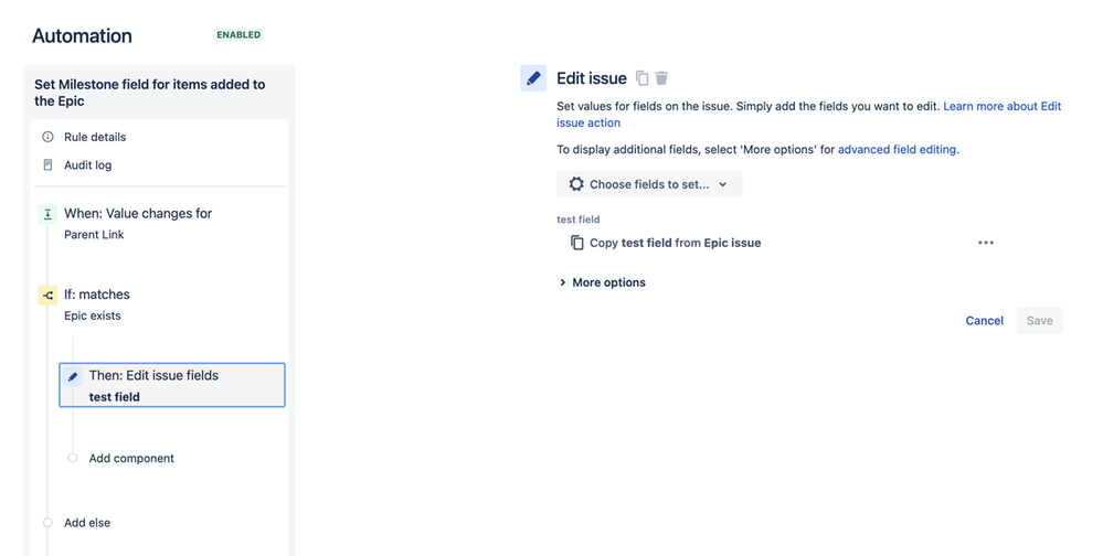

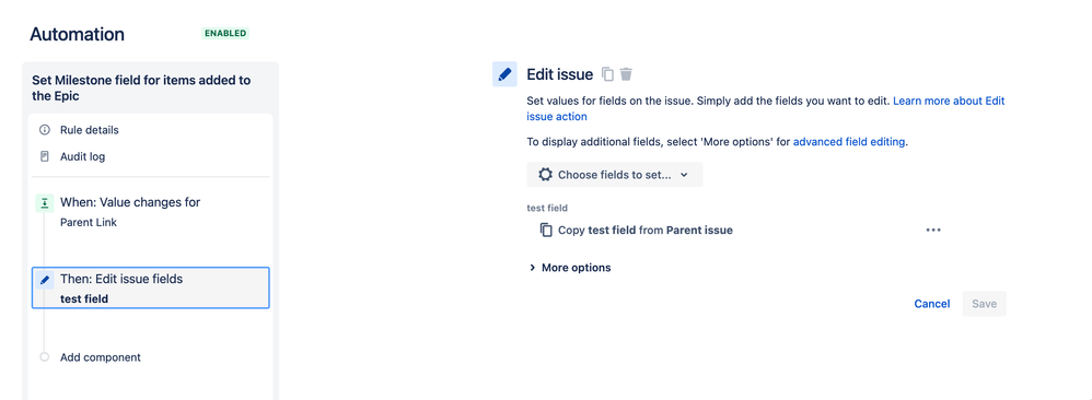

I'm trying to create an automation that will set the value of a custom field to the same value as their parent Epic.
So far I was able to make it work only for already existing items within Epic, but cannot make it work to set the value for newly added child items or items added outside of the current Epic.

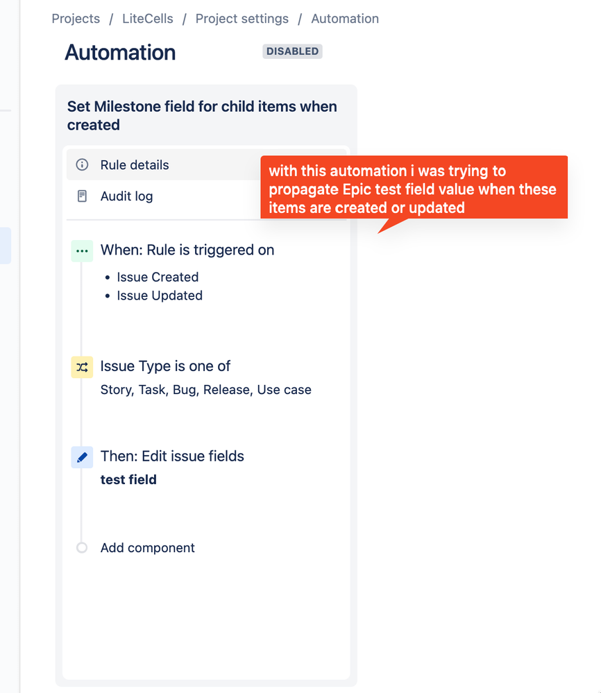

Please see 2 screenshots with the automations I tried.

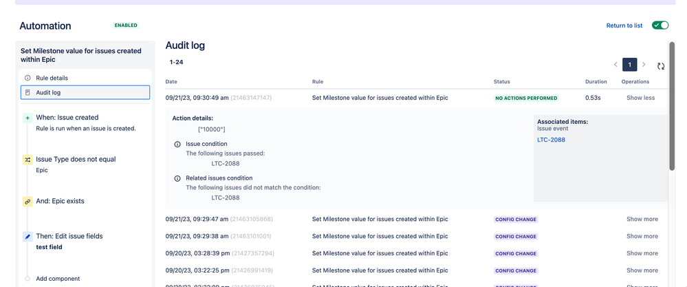

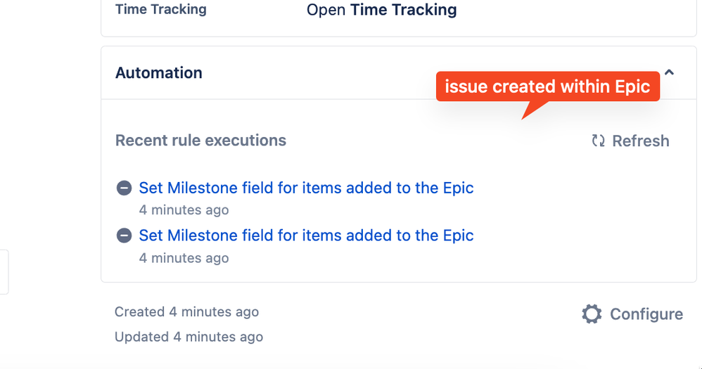

I believe the problem is that when I create a task even using "Add a child issue" for the specific Epic, it doesn't relate to any parent/Epic yet so it cannot understand where to take the value from. This is how I understand the error message shown in audit log (see attached).
And only after I perform some changes on child item it gets the value from the parent Epic.

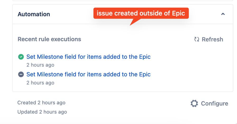

And even for the other case when I link items to the Epic created outside of it - rule executes twice, where first execution always fails but the second works.
p.s. In all cases the rule tries to execute twice. does it works the same for you?

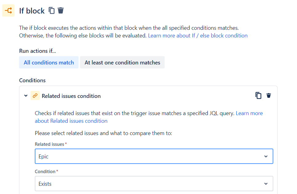

I guess changing the Epic works like clearing the previous one and adding the new one in two steps. I experienced the same before but not this time when creating the screenshot for you. Add an IF, ELSE condition after the trigger to set the given field only if the trigger issue has an epic:
You can use the else branch to empty the value of the given field of the issue if it does not have an epic.

after adding the if block the rule still tries to execute twice.
For items created without Epic and then added into it -> first execution does nothing, second execution successful
For items created within Epic via "Add a child issue" -> both execution do nothing

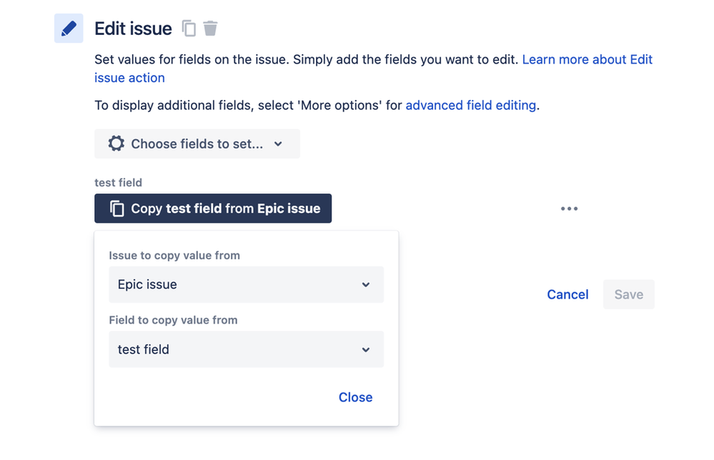

I tried both options to set "Issue to copy value from" as Epic issue and Parent issue.
For the first automation that works it is set to "Epic issue".
From the rule I want to achieve that all child items inside the Epic got the same value for "test field" as it is for the Epic.
And the rule should be applied no matter if they:
- were inside this Epic before,
- were just added from backlog or from another Epic;
- or were just created by clicking "Add a child issue" right under that Epic
I hope it makes clear what I'm trying to achieve.

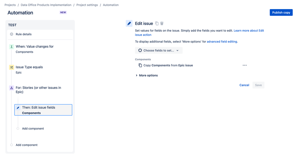

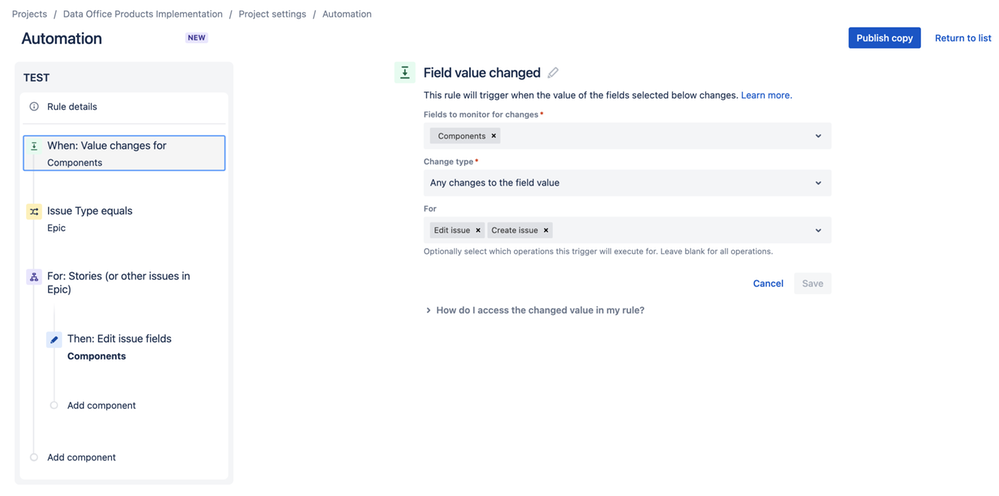

I have a similar rule to this one, that I think is can help you for your purpose:
Lets say you want to populate down the component values:

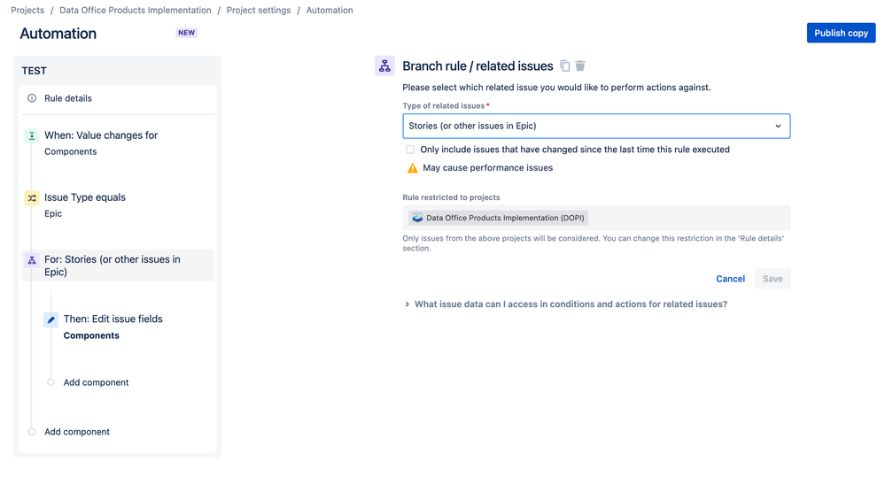

Now you create a branch for all issues within that epic:
and you copy the component field from the epic:
I hope it helps,
David

I was trying to use "Value changes for Parent Link", but it doesn't affect issues that I create within Epic using "Add a child issue" button. It works only for issues that I created in backlog with no Epic -> and only then put them inside the given Epic.

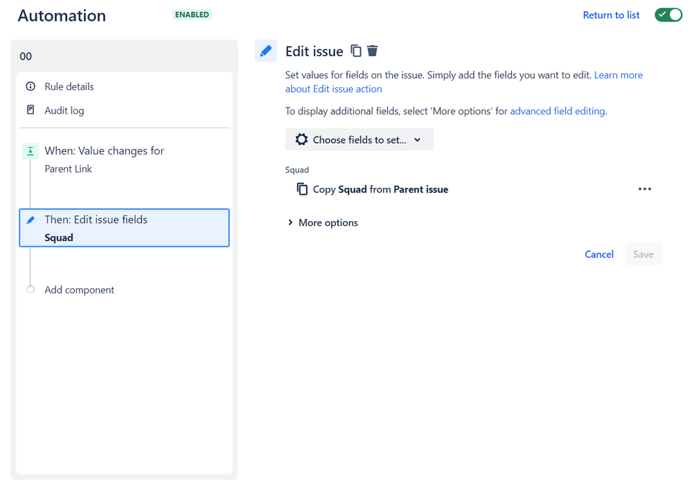

For this case I created a separate automation and this is how it looks like now:
Do you know how to solve this case? There must be some error as it doesn't work for me, but I don't understand what I'm doing wrongly

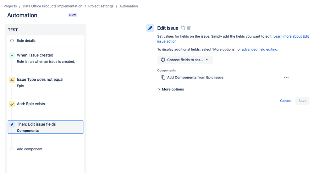

@Vasilisa Yermakova for this case in a similar way:
The rule is triggered when an issue is created, then you check it is not an Epic and it has an Epic linked, then you update your field (in the sample I use component) to update the field based on the corresponding Epic value.
The condition Epic exists is the following:

I've created the exact same rule, but still it shows that newly created issue didn't match the condition so the rule don't perform any actions.
Can it be that Epic still doesn't exist for the issue when I create it as a child for Epic?
As I understand from the audit log the operation that fails is "And Epic exists", but I don't understand why. I thought it may be connected to the "Rule restricted to projects", but I'm in the right project doing all these changes.

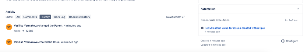

You can see on the screenshots attached the details from audit log and History for newly created issue (LTC-2088)
Well, the rule assumes the epic exists you need to link an existing epic on creation. The rule is triggered when the child issue is created. Did you try to log the information (Log Action) to see what is entering into the rule, to have more information.
