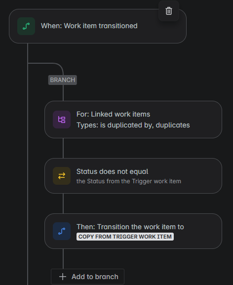

To avoid this resynch, I tried to add an if statement in the branch, but for some reason the automation will always pass on that if statement and try to update the status for a 2nd time.
First of all: I thought rules should not be able to trigger themselves so why does the status change of the first run through the rule, trigger itself again? Is this because it is being triggered on a different work item?
2nd: why does my if statement not stop the 2nd run through the rule and still attempt to transition again?

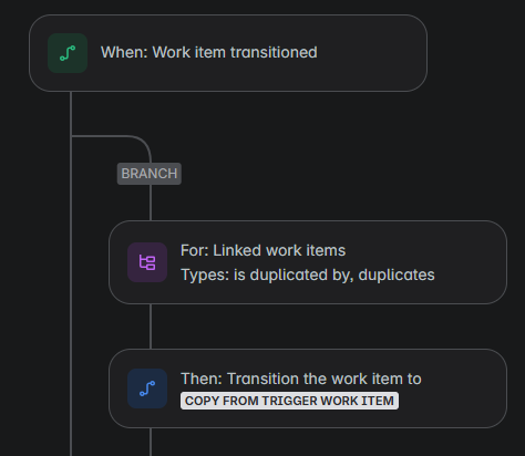

In your automation, you have a non-descript trigger followed by a branch that is allowed to change the status for both “is duplicate” and “duplicates” conditions. That in itself generates the infinite loop if the automation is allowed to start itself.
How to avoid this from happening?
You should construct two automations, nearly identical, yet each with its own singular branch: so one for “is duplicate”, and the other for “duplicates”.
Only one of these automations should be set to be able to be triggered by other automations.
This means that you should choose which of the branches should override the other, the automation with the overridable branch should be set to “can be triggered by other automations”

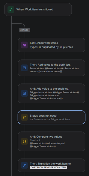

I had added a smart value if statement and that one seems to trigger correctly
It would probably be helpful to understand why these 2 if statements are not the same, however I can work with this

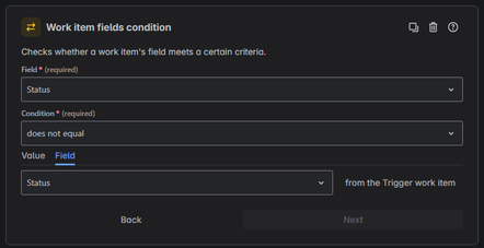

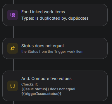

Can you provide a screen image showing the details of the "Status does not equal" component?
Can you add the Log actions that I recommended, placing them before the "Status does not equal" component, run the rule again, and share screen images showing all the details from the Audit Log for execution of the rule?

Both projects involved are company managed software projects and they share the same configurations: issue types, schemes, workflows, fields....

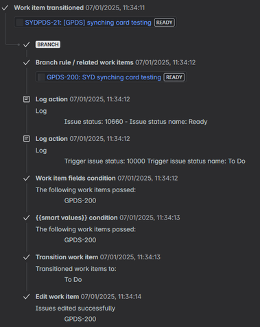

Log when status field on both work items are different:

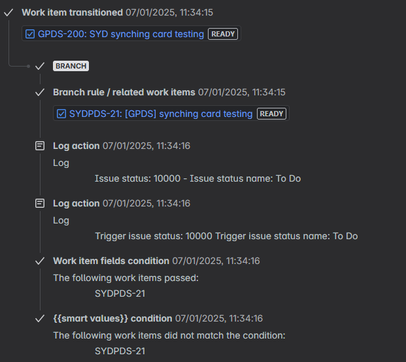

Log when both items are the same (runs automatically again because last action of previous run, makes it run again)
Config of the work item field condition check which passes in both runs above
Automation rule:

As it stands now the work Items Field condition and the Smart value condition are getting the same results. I would like to see if removing the smart value condition will result in the problem occuring again. If it does then I would suspect a timing issue where the rule is running before the data is truly saved in the database.
in the case where the status values are different, both conditions show a different result.
The work item field condition shows it passes, the smart values condition says it does not pass...
If I remove the smart value comparison I will get an error because the next step is to transition the card which it cant do as the workflow does not allow transition to the same status value.
