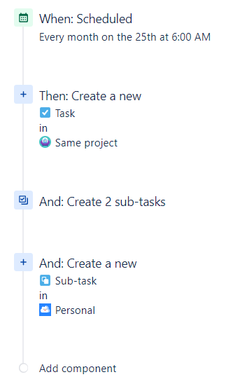

Which of the rules from the 2 screenshots does work?
From the first screenshot the first action (create issue "task") says it´s created in the same project. The last action (create subtask) then shows a specific project. So my questions are:
  • What is the 2nd action processing (create 2 subtasks)?
  • What should the last action process (create subtask in specific project)?
Could you please add screenshots showing the configuration of these 2 actions?

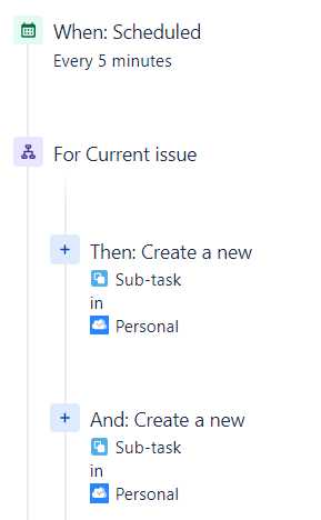

The 2nd screenshot starts with a scheduled trigger and immediatly branches for "current issue". As there is no specific issue that is initiated with the trigger the branch cannot rely on any "current issue".

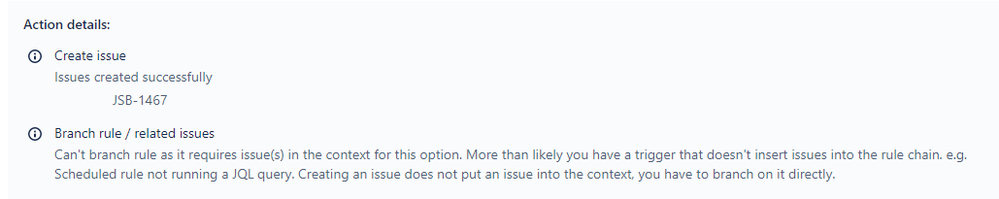

Please check and/or send a screenshot of the audit log (of an activation of this rule).

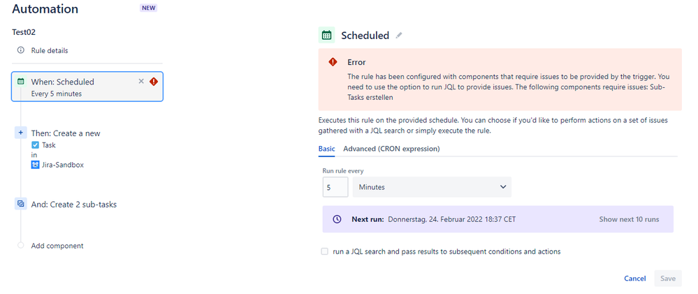

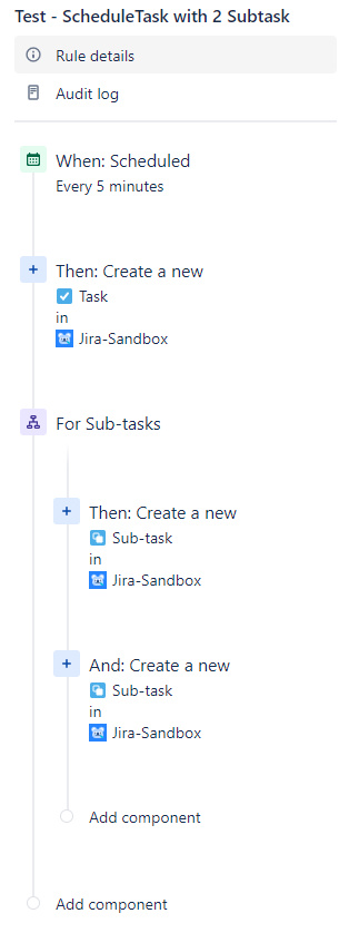

I switch everything to English and runs the process once more. That the workflow:

the branch "for subtasks" would refer to the subtasks of an issue. As the task was just created there are no subtask to "grab" for the branch.

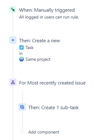

In order to create subtasks for the lately created issue use the branch "recently created issue". This would set the previously created issue in the context of "current issue" and the "create subtask" action will then be processed for this this issue. (created a screenshot of how this could look like)

Hi Stefan, That was the magic trick: "recently created process". - It works. - As suspected, if you know how to do it, it's totally easy. I have a hard time interpreting the terms and always wonder what the author means. Even in my mother tongue I didn't understand, because then the translation is probably not optimal. Thanks Ramaka

see my previous answer. An automation rule/action always refers to a context (you can see it like a variable) named issue (that reaction then can refer to).
When a rule is triggered by an issue the {{issue}} is automatically set and handed over to the automation rule (this can then also be used in smart values to get information of the issue like {{issue.key}} for further processing). In this case the rule has a scheduled trigger (not an issue) therefore the system cannot set {{issue}} to a specific value as there is nothing handed over on the trigger.
