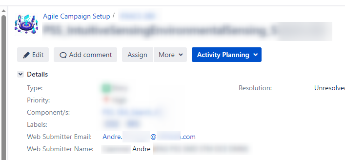

Thanks for replying. I'm not sure if this is a native feature. Here is a screenshot of the form. The URL of the form begins with "https://jiradashboard-git-jira-dashboard.eu-de-..."2023-07-31_14h36_09.png

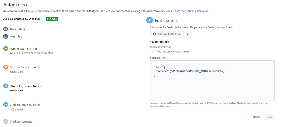

I found out that the Web Submitter Email, which has the correct name of the person I want to set as the reporter, is a custom field with title "customfield_10403"
I've tried the following code, but it is generating an error "Error while parsing additional fields. Not valid JSON."
"fields": {
"reporter": {{customfield_10403}}
Apologies if this is really basic stuff, I am not a programmer, just someone trying to figure this out :)
Quang Nguyen August 1, 2023
I have also tried the following, which generates the error "(Reporter is required. (reporter))"

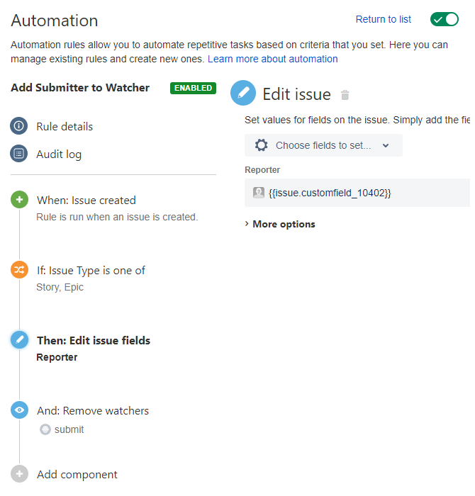

It worked for me - what I did was:
  • Chose the Reporter field from the dropdown, rather than using the "Additional fields" section
  • Entered the smart value as - {{issue.customfield_10402}} into that field
For reference, I used a text field to store the email address - is that the same as your custom field?
Ste
Hi Stephen,
When I tried this I got the error:
"Error editing issues
IFXACS-388 (The reporter specified is not a user. (reporter))"
customfield_10402 is the text field "Web Submitter Email", clicking on it hyperlinks to sending them an email in my mail client.
customfield_10403 is the field containing their name and employee designation. I have tried both and they generate the same error.
Here is the screenshot of my setting:2023-07-26_13h34_14.png
