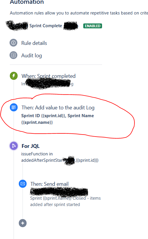

I have set up an automation rule (trigger Sprint Completed) to send an email listing all items added after the sprint began. When I manually test the rule, either before or after the sprint ends, the JQL functions correctly. However, when the rule is triggered automatically at the sprint completion, the JQL returns no results. Do you have any insights into why this might be happening or any potential workarounds?
The log message "Sprint ID {{sprint.id}}, Sprint Name {{sprint.name}}" returns the correct values both during testing and when the rule executes automatically (sprint completes), so the issue doesn't seem to be there.
The JQL used is: issueFunction in addedAfterSprintStart(<Board ID hardcoded>,{{sprint.id}})
This JQL is executed within a "Branch Rule" because some fields are otherwise inaccessible.
I hope this information is sufficient, but please let me know if anything is unclear. Thank you in advance.

Hello, thank you both for your input. The rule functions perfectly when the trigger is set to "Manual". However, it does not work when the trigger type is "Sprint Complete" The logs display the correct {{}} values (highlighted in red in the screenshot). To address your questions:
I iterate through the results using #issues to construct the email body.
I can confirm that no results are being retrieved, as indicated by the Audit Log ("No related issues could be found") and the fact that the email is empty.
The {{sprint.id}} is used without quotes.
The option to execute only items since changed is NOT selected.
The query executes successfully in the JQL prompt UI and, as mentioned above, when running this script in manual mode the log shows all the Keys resulted from the JQL and the e-mail has all items expected.

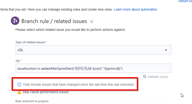

Without having any of the details my best guess/first question would be if you the option is selected/deselected in your jql-branch that only issues will be taken into context that have been changed since last run of this rule (see screenshot).
furthermore:
did you set the smart value of sprint.id into quotation marks so it represents a string?
