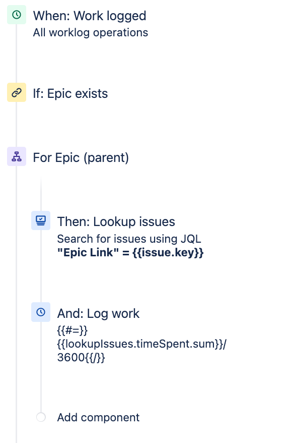

My goal: Create automation that will sum up the time spent entered on tasks to the epic level.
Problem: The below automation works... to an extent. If I enter 1h on a task within an epic, it will show 1h logged on the epic. If I log another 1h on the same task or another task within the same epic, then it will show 3h logged on the epic. This makes me believe the automation sums up all time spent entries (previous and new ones). Is there a way to get the automation to only sum up new time spent entries since the last time the automation was run?

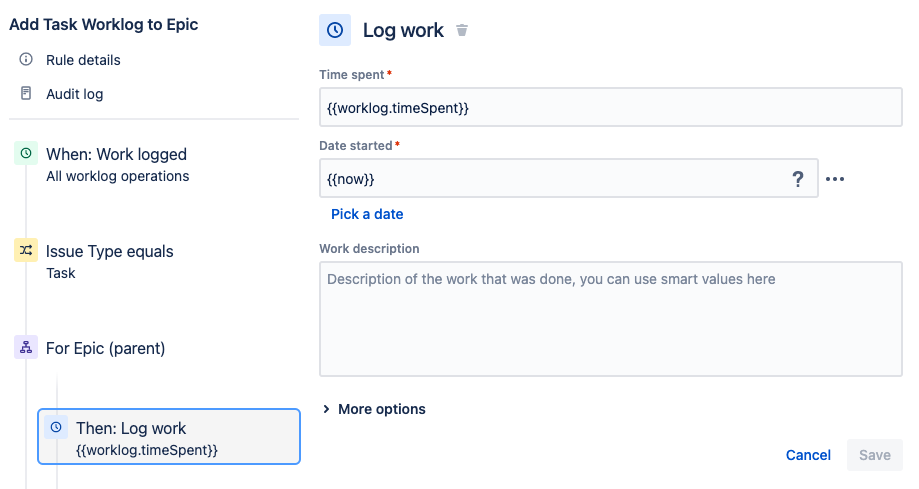

Hi - so I see a few issues:
  • You probably want to add a condition so the rule only runs when you're logging time on a TASK.
  • You probably just need to add this value to Log work: {{worklog.timeSpent}} for the Epic and you don't have to Lookup anything.
So how this would work is:
You update task PROJECTX-123 which is part of epic PROJECTX-123.
  • Rule checks if it is a Task (because if it is an Epic, you would not want to double-log the time.)
  • If it is a Task, the For Epic (parent): Log work {{worklog.timeSpent}}
Darryl Lee
April 26, 2022
(You don't have to check for only Task. It can be any child-Issue Type.)
Like # people like this
Brellison April 28, 2022
Sweet! This fixes my problem. Thanks @Darryl Lee

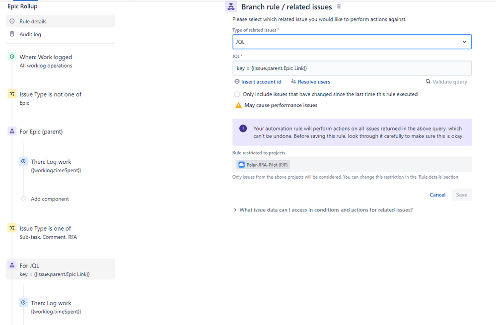

Vinod Kotiya
January 16, 2023
Here is the solution to Rollup time spent to Epic Level. When time is lgged in Task/Stories and Subtask level.  Working perfectly fine.
First check is for non-Epic, a second check is for some subtasks.
