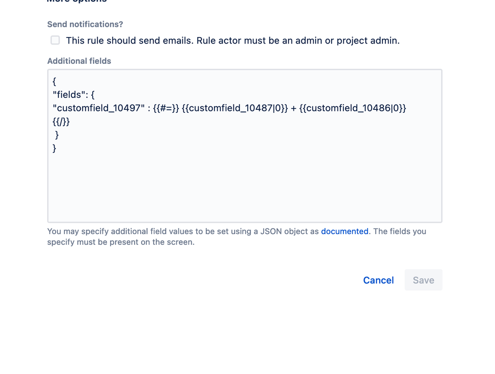

I'm running into the same issue, and no matter what I do, the custom_field in the parent also resets to 0.
I'm using {{#=}}{{lookupIssues.customfield_14478.sum|0}} + {{lookupIssues.customfield_14474.sum|0}}{{/}} as my lookup.
I am also using "For: Parent" in my branch, as I know Epic (Parent) is being deprecated.
Very frustrating as this seems so basic, yet failing to sum correctly.
