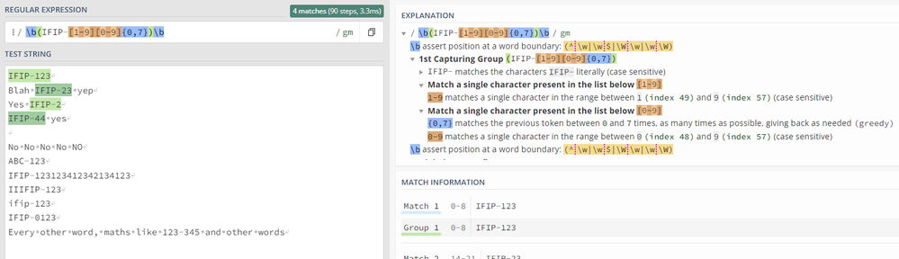

To reduce false-positives, I use the regex [1-9][0-9]{0,7} to ensure the first digit isn't a 0, and there's up to 8 digits in total after the project key.

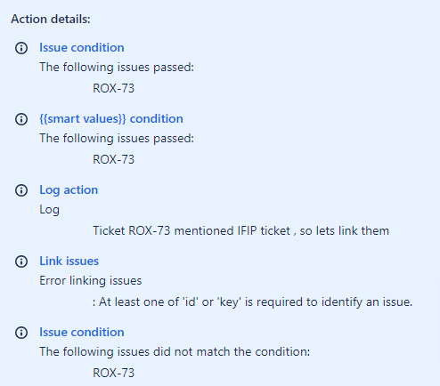

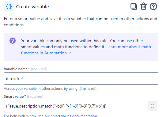

With or without the quotes, this fails to put a value into the ifipTicket smart variable (see screen shot). I think the single curly braces are an issue, but they are correct regex syntax.
{{issue.description.match("\b(IFIP-[1-9][0-9]{0,7})\b")}}

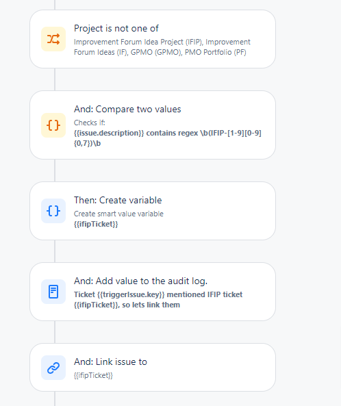

The same regex syntax correctly identifies the Jira key in a filter step (see attachment), but provides a null string when used in the .match
What am I doing wrong? Do I need to escape the single curly braces, or have I just plain missed something?

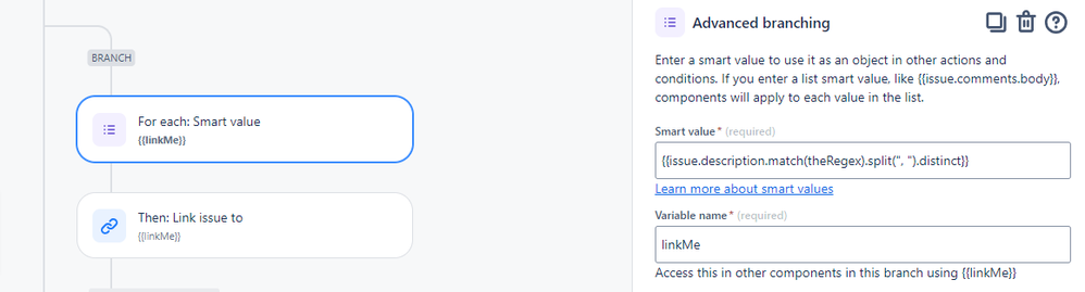

The result is the/each IFIP ID, twice, which I then split and get the distinct vale(s) from.
{{ifipTicket.split(", ").distinct}}
I now need to split that and iterate through to add links to each IFIP ID, which for anyone trying to do something similar, is done like this:
