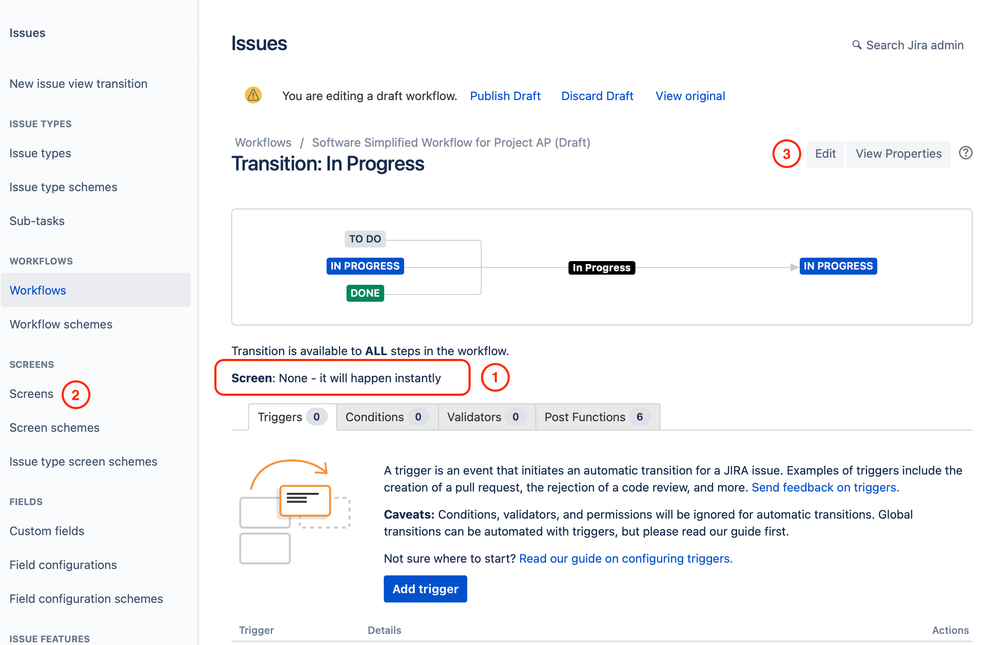

What I mean by this is you need to configure your workflow so that when you transition an issue to In Progress, a screen will pop-up to ask for the Assignee.
You do this in the workflow editor.
1. In this case there is no screen association with the transition to "In Progress".
2. Use the screens section to create a new screen and add the Assignee field to it.
3. Edit the transition and select the screen you created in 2.
Finally, publish the draft workflow.
Now your automation rule will succeed as there is a screen attached to the transition which contains the assignee field.

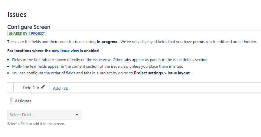

I created the screen and named it "In Progress" and added the Assignee field:

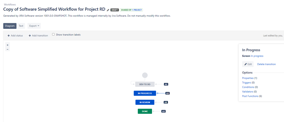

I added the screen to the transition:

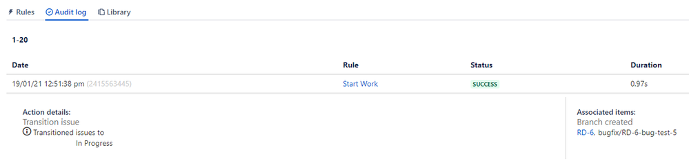

Log says it worked, but field is still not set...
Transition is OK but not the field:

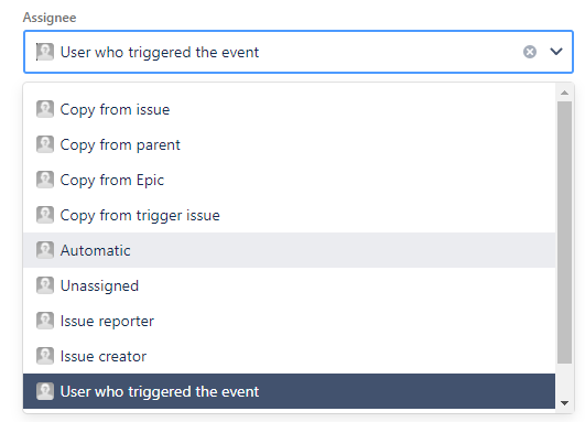

Ok the issue was now that the option "User who triggered the event" doesn't work:
I also tried Automatic and it didn't set, which option should I use to set the assignee as the person that created the branch? (I'm creating the branches inside Jira).

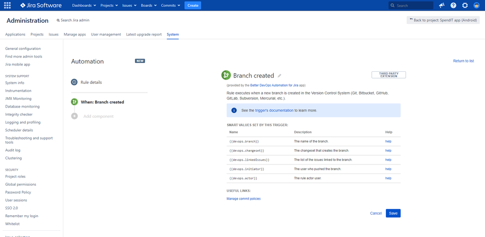

I'm a bit confused if it is for Jira Cloud or Jira Server/Data Center? (Some screenshot in the topic are definitely cloud, others are not.)
For Data Center and Server, you should use the Branch Created Trigger which makes the branch creator available through the smart value {{devops.initiator}}.
Here is a recipe that show how to assign an issue to the committer. It may be exactly what you need or the script may need some tweaking.
devops-automation-rule-branch-created
