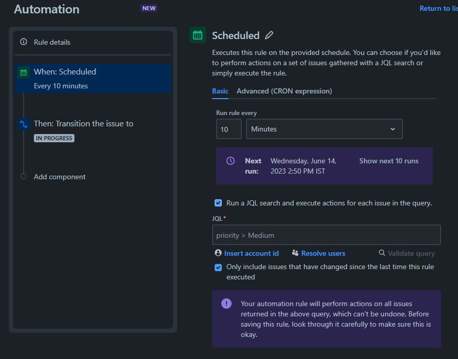

Hi @Wynand Bouchaud ,
Yes it is possible with Automation Rules. You can create a "Scheduled" trigger and configure your JQL Query (which can filter out tickets based on your time requirements). Please refer the screenshot below.
You can also refer the Automation documentation here.
Aditya

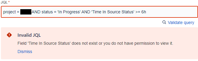

Wynand Bouchaud June 14, 2023 edited
Hi @Aditya Verma ,
thanks so much for your quick response. I've now managed to get that far, but I think my JQL is not liking my parameters being set, per the below screen shot. The issue I'm facing is to ensure that the query runs, and only executes once a ticket is over 6 hrs, but I'm getting the error. Am I doing something wrong, or should I request higher access?JQL.png
I've discovered the answer, end should look like this:
AND status = "In Progress" AND updatedDate <= "-6h"
thanks though @Aditya Verma

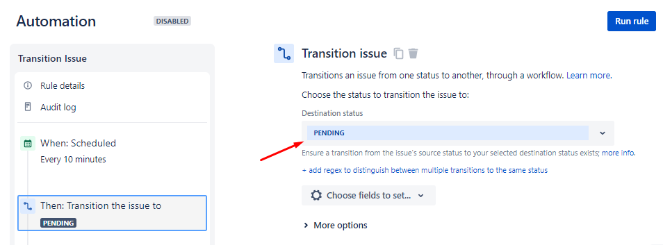

Hi @Wynand Bouchaud , as the friend said in the previous answer, yes it is possible with the Automation Rules.
Start with a "Scheduled" trigger.
Then, in the example below, I created a filter with a project created greater than or equal to 6 hours and with a status of Work in progress.
Then add "Transition Issue" action to Pending status.
If it works please mark as accepted answer.
Thanks!
