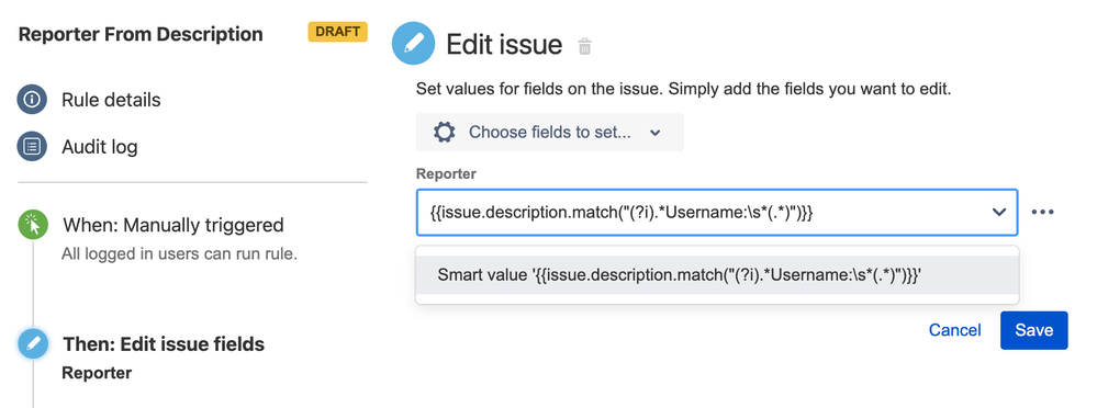

Hi @Hellen Braun -- we should probably ask are you running on Jira Cloud or Server/Data Center?
If you are on Cloud, then what @Bill Sheboy points out is correct, and you CANNOT use a username (example: darryllee) to set the Reporter. You would need to follow the example I linked to, which is almost exactly what you are asking for:
If you're on Server/DC, you don't need to mess with looking up the accountId. The on-prem versions of Jira still allow usernames.
But in both cases, you don't have to mess with JSON at all! Once you get the username or user accountId, can use Smart values when editing the Reporter field, like so if you were using Server/DC, you could do this:
(I use a Manual trigger for testing.)
The way you add a Smart value is to start typing in that field, and then when you're finished, click on the pop-up option that shows up.
