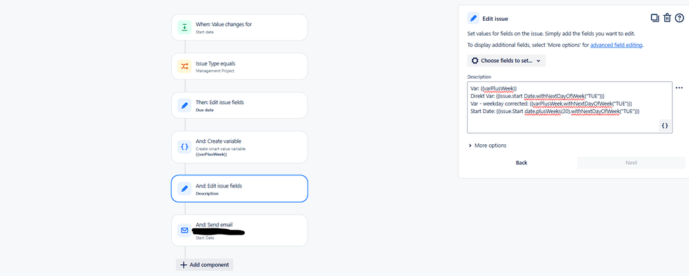

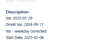

Chris M_ September 2, 2024
Thanks for your help @Gaurav!
Now, it works!!! :) But I don't understand why. I can also use start Date for a single calculation but if I use it for a chain the is no result. With your help I used Start date and now it is possible to calculate the result.
