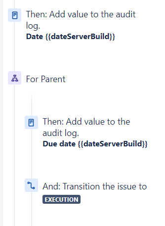

Hi, I am trying to set due dates based on the Component that is set on the Story (Small, Medium, Large).  Note that I copy the Components to the sub-tasks in an attempt to simplify the logic of looking up the Components.
I created an if else-if branch to manage these three conditions, and in each I set a variable to hold the date.
Right after the variable is set, I have a For Parent branch to create sub-tasks and assign due dates...but they are turning up blank.
So I added a test audit log entry to see if the variable existed even just after the if else-if branch ended and it doesn't.  It's already null.
I can see in the rule audit log that the condition passes successfully so why is my variable null?
thanks

Is the log action within the if/else block or outside? The screenshots indicate that it is outside of the if/else block and that would explain why the variable is null. A smart value that is created with a if/else block is only available within that block and cannot be accessed outside of it.

It depends on where you create the variable. If you look in the article they are creating the variable first before using it in the branch. If the variable is created with the branch, you will not be able to access it outside of that branch, that's the difference.

@Mikael Sandberg yes you're right -- but the value of the variable is based on which Component is tagged so I have no choice but to set it in an if/else block.

I haven't tried this but can you create it outside the if/else block and then set in inside?

@Kelly Arrey yes, if you create the variable outside of the if/else block it becomes a global variable and can then be used inside the if/else block. Have a look at the article above that Derek linked to.

@Derek F You can set the variable to null outside of the if/else block and then use it within to set it to the right value.

I reread that a few times so...I use "create a variable" to create it before the loop and then "create a variable" again to set it to the actual value I want and use it?

Correct, you will have to use the create a variable multiple times, but as long as you use the same name it will just update the value for the variable.
