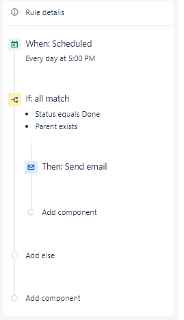

Here is the rule as I have it now. I think I may have got the linked issues worked out with 'Parent exists'. I still have no idea how to email the Parent assignee though.

Well, it looks like I figured out how to email the epic assignee with {{issue.parent.assignee.emailAddress}} but the email did not show the issue that should have been reported with the conditions.
I'm getting there!!   :)
