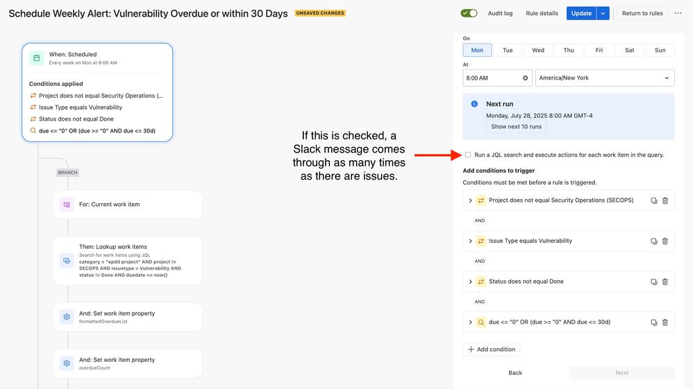

I am trying to create a weekly Slack Report using Jira automation for issues that are near due or overdue and have the Slack alert formatted to show the count of issues in each category and the list of issues with some of their details.

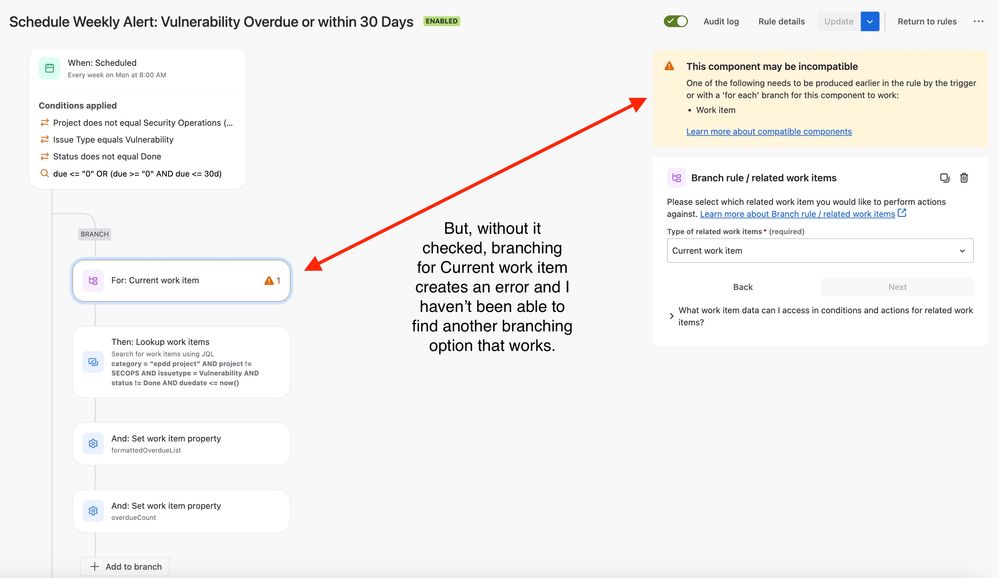

I can trigger the automation successfully when I manually trigger it, but when I try to run the scheduled one, it is sending the message 3 times. I turned off the checkbox for running the rule for all issues triggered as I thought that may be why but I'm now getting new error messages.
I have been branching for Overdue and then a new branch for near due but I don't seem to have a good option for branching. I currently have for Current Work Item, but I can see why that is triggering a message. I have been circling on this for hours over the past 2 days and it's driving me bonkers at this point.
Here are some screenshots of what I'm doing, what I'm seeing and a Slack message that worked when run manually.
When you want a scheduled rule to run and to send a single message, do not include the JQL in the Scheduled trigger. Instead, use the Lookup Work Items action with the JQL to gather the work items and then iterate over them in the message.
And...rather than use conditions, add all the criteria to the JQL.
For example:
I added a smart values condition so the message is not sent when there are no results found. You could instead remove that and tailor the message send a "nothing found" type of message.

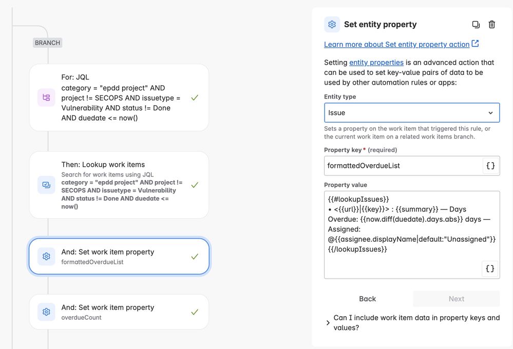

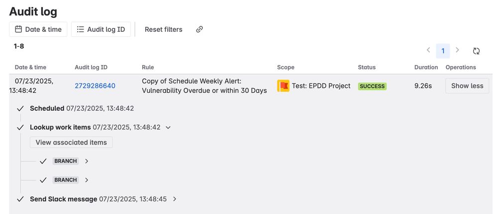

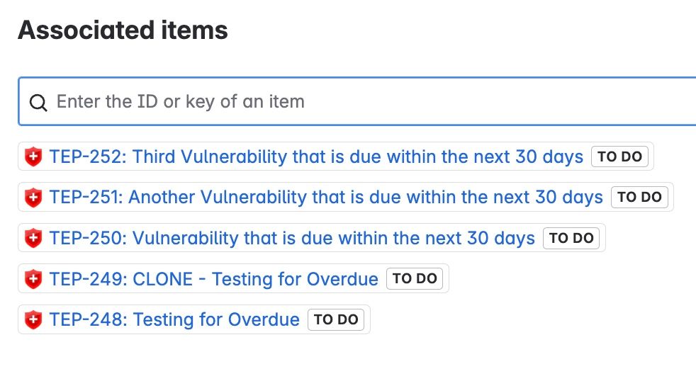

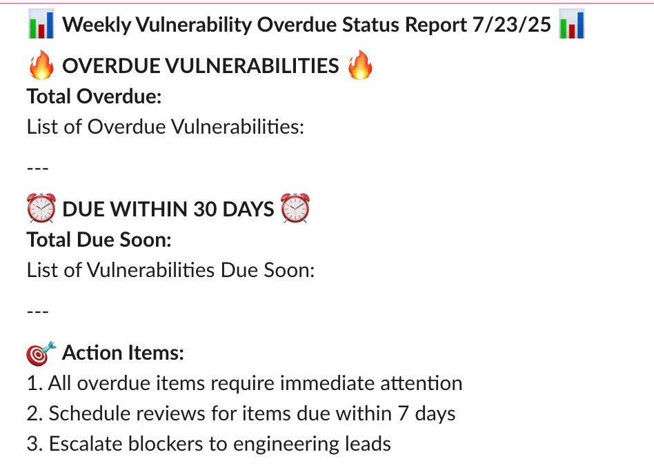

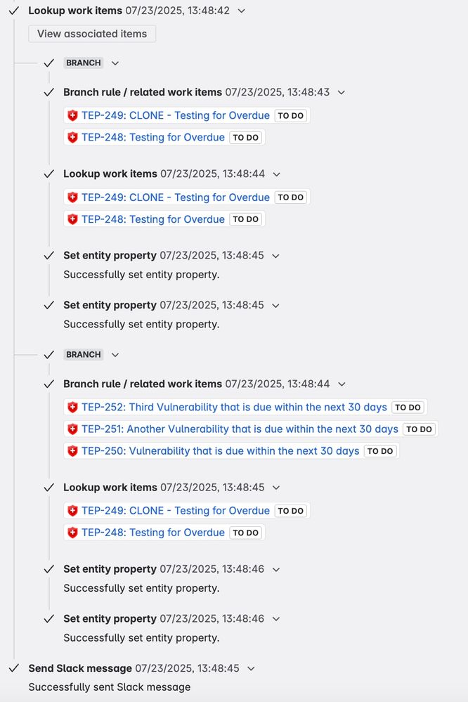

Here is the full automation. I'm doing my best but I'm still a bit of a beginner with the smart values. I did move up the Lookup issues before the branching and changed the action to branch by JQL but seeing the whole automation will likely more make sense b/c one Slack message is being sent for the overdue and near due for the weekly report. Once I changed to the following - I now get one message but no values.

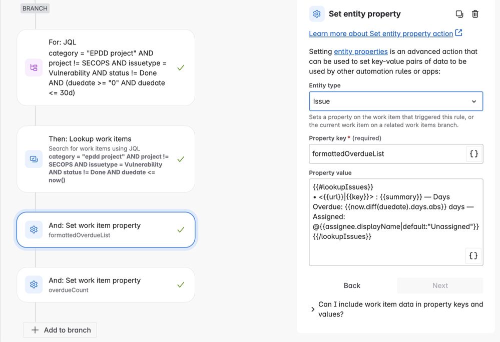

The first branch:

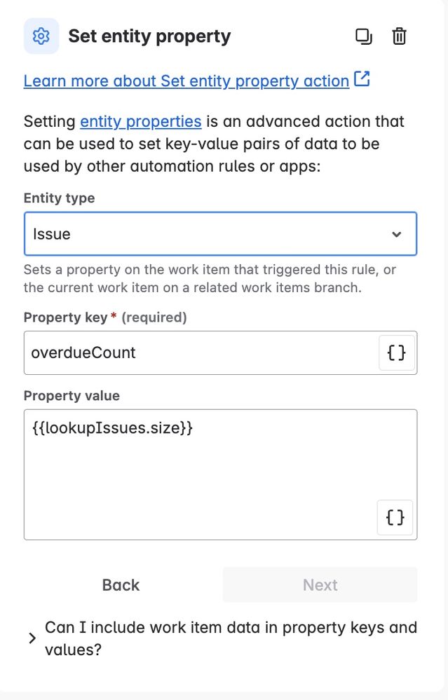

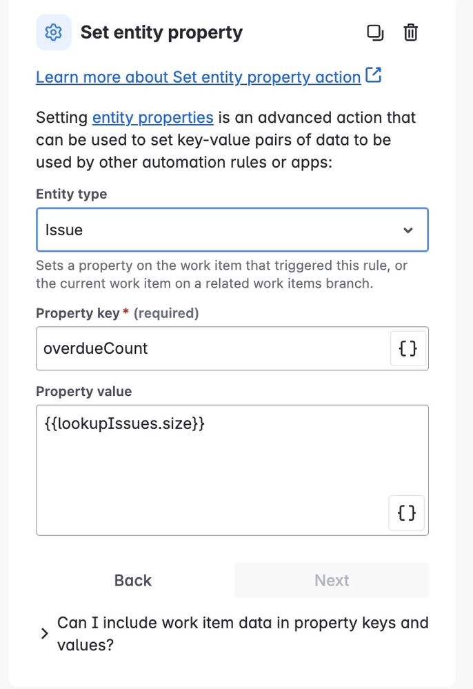

This is the details for the second Set Entity Property:
The second branch details:
Details of the second Set Identity Property in the 2nd branch:

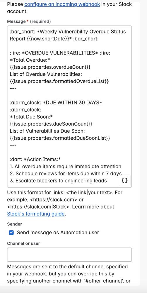

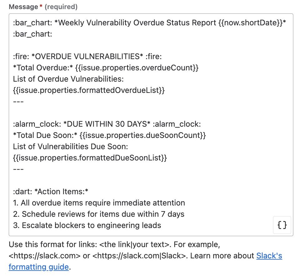

Details for the Send Slack Message after the 2 branches:

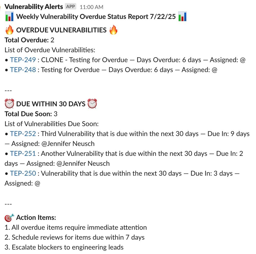

Slack message that came this time w/o the values:
And the Audit Log Details:

Let's back up a bit: what problem are you trying to solve? That is, "why do this?" and "what does success look like?" That context may help clarify the scenario.
For the rule information you show...
What is the purpose of setting the entity properties?
And if they are necessary, where should the values be stored as the values appear to span multiple work items?
What is the purpose of branching? I was suggesting the use of Lookup Work Items so the branching is not necessary to send a single message.

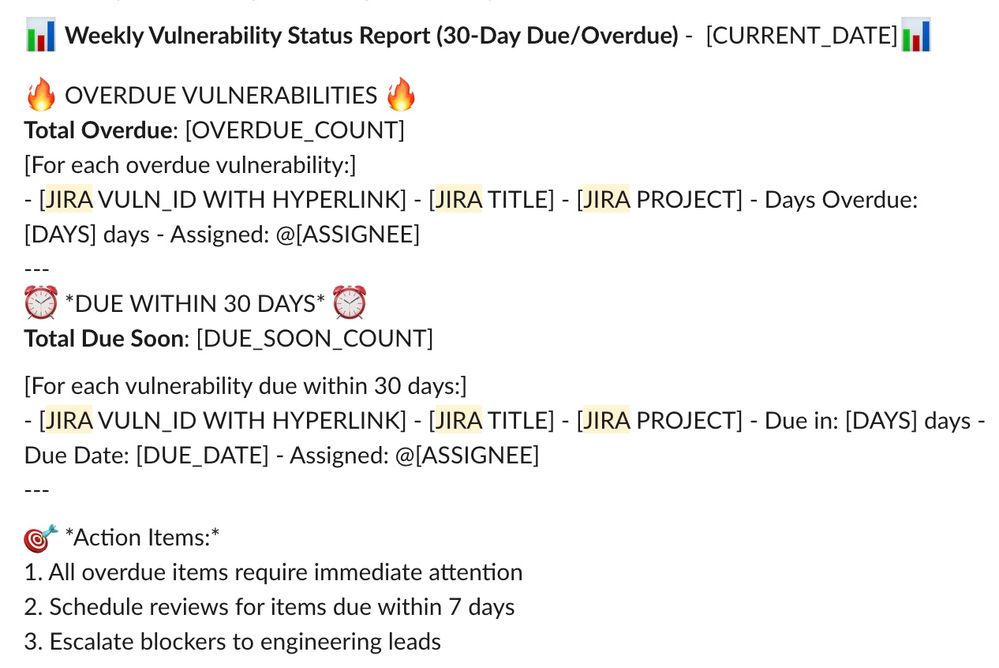

I love that question - always such a great one. The request that I got was to create a very specific templated report in Slack every Monday am for awareness of any overdue or near due vulnerabilities as shown:
I had started out with a completely different approach. I was going to have a branch for Overdue and send the Slack for overdue count and the list of issues. Then the second branch would do the same for the near due and a final step would be to add the Slack message for the Action Items.

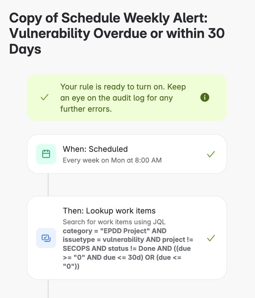

Thanks for the additional details, and I believe my earlier suggestion will help with a slight modification to allow getting both the overdue and due-soon items. This aspect would use smart value, list filtering to help.
project != SECOPS
AND category = "EPDD Project"
AND issuetype = Vulnerability
AND status != Done
AND (
due <= startOfDay()
OR ( due > endOfDay()
AND due <= 30d)

And thus, it does not appear there is a need for the entity properties. Would you agree?

And I would agree that there doesn't appear to be a need for the entity properties. I was just so turned around that I was grasping at anything at that point.

I have one small question that I'm sure is a small tweak but I can't figure it out! It's pulling in 4 issues instead of 5 because one of them has today's date for the due within 30 days. How can I update it so that it will include any issues with the date the rule runs as well. The JQL does return them all.
Jennie
Whew: aren't edge cases great :^)
I updated my earlier suggestion and here is the summary of what changed:
The duedate smart value is a date and now is a date / time. Comparing them is challenging...even when using the conversion functions. It is simpler to use diff() and get numbers for comparisons.
Assuming we want "today" in the "due in the next 30 days" category, the condition changes to this:
{{#if(and(now.diff(duedate).days.gte(0), now.diff(duedate).days.lte(30)))}}
And, while testing, I was reminded of a defect in lookup result iterators with dates, forcing a change in the list details:
* <{{url}}|{{key}}> -- {{summary.abbreviate(10)}} -- due in: {{duedate.diff(now).days.abs}} day(s)
The earlier version had now before duedate, which will always use the first record found in the lookup, not the current one. This is a known defect. For some reason, this defect does not impact the filtering, but only the iteration value / output.
Please try those changes and let me know what you observe. Thanks!

You are awesome. It's not only working perfectly now, I have learned a lot in the meantime!
