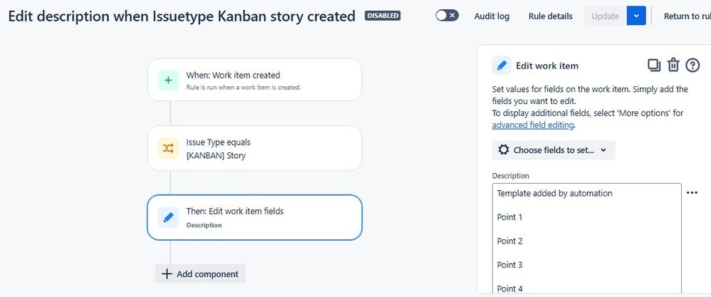

When issue type = kanban story created then add following points in description
Point 1
Point 2
Point 3

1. How to check which environment I am using - If I am not wrong it's JIRA cloud.
2. Image showing entire rule below (I did not enable this rule yet)
Here is the rule I created.

Thank you for the image of the rule.
What is your question about this rule? What are you trying to accomplish?
What you have will be triggered after the new issue of type [KANBAN] Story is initially saved, and whatever exists in the Description field in that issue will be removed and replaced by the text you have put into the Description field in the Edit action.
