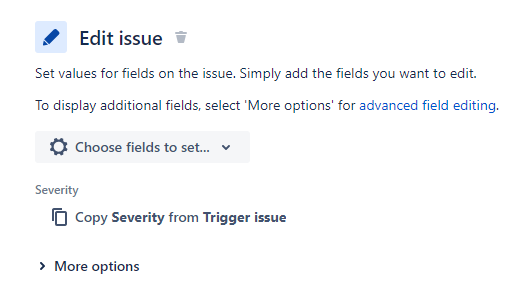

Also isn't the field/s available from the "Edit issue" action list of fields?

the Severity field is in the drop down list. Selecting that field out of the drop down was the first thing I tried but received this message
Found multiple fields with the same name and type: .
Severity (com.atlassian.jira.plugin.system.customfieldtypes:select)
which is why I tortured myself with json.
