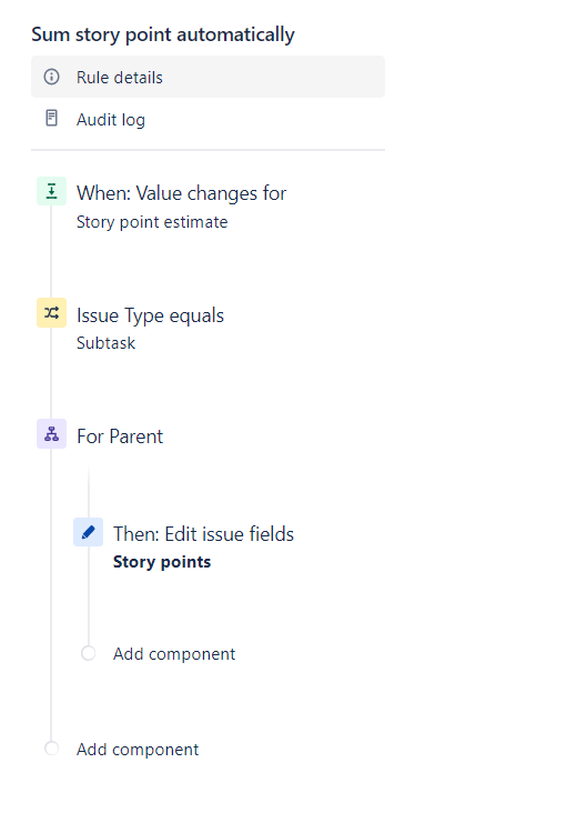

what I want to do is to sum the story points of all subtasks automatically for one user story or task. and I created a new automation rule for it. and I activated the "story points" for estimation in the project setting=>feature.
I will attach the screenshot I have made in the automation rule.

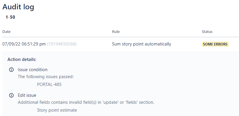

The issue comes in the 3rd step "Edit issue fields", I can't find the "Story point estimate" in the dropdown list. and so, the rule can't run well.
looking forward to your solutions!

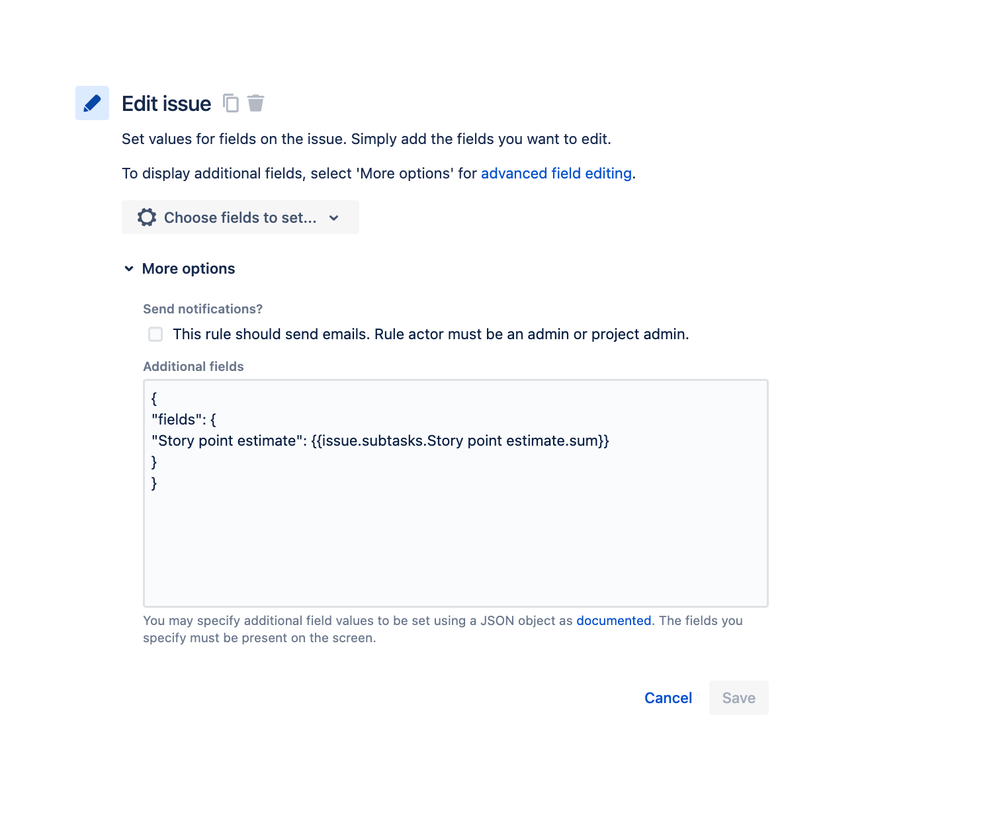

Within team-managed projects this field is called "Story point estimation". Unfortunately (as you already pointed out correctly) this cannot be chosen in the dropdown field so the advanced edit function via JSON needs to be used. I tried this in my environment and it worked (see the screenshot):
I´ll add this here as text so you can copy this directly:
"fields": {
"Story point estimate": {{issue.subtasks.Story point estimate.sum}}
Please give it a shot and let me know if it works.

Which issue type is the issue "PORTAL-485" that should be edited in your audit log screenshot?

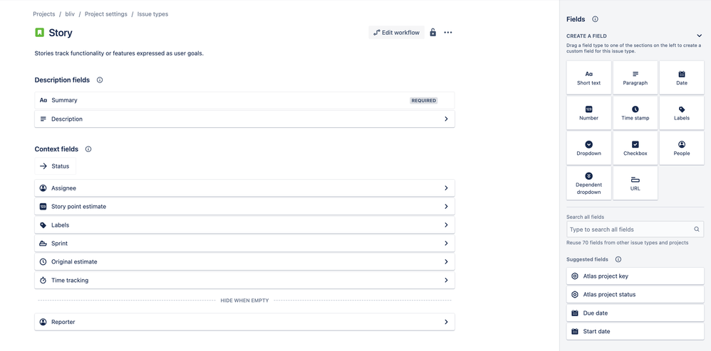

From your former screenshot of issue types settings I can see that there is a field "Story point estimate" in issue type "Story".

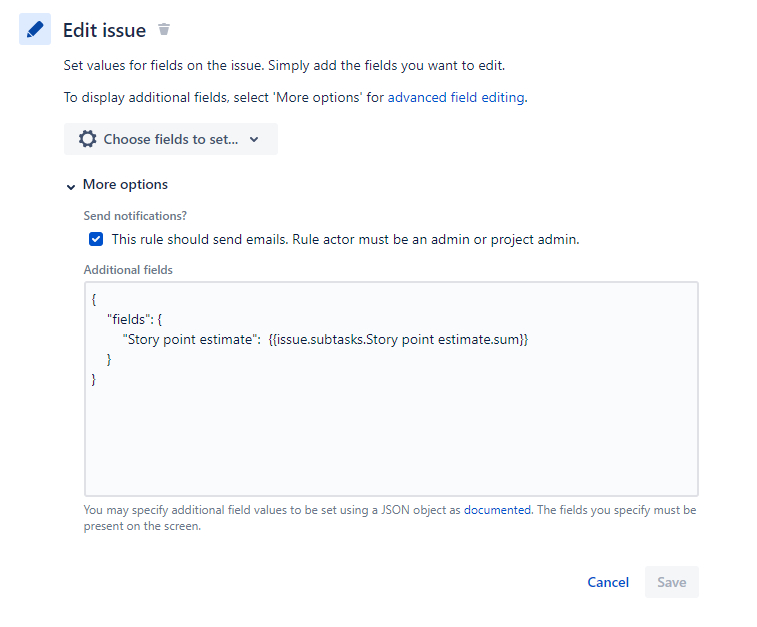

I have a similar problem, following your steps. After I tried your suggestion before, it still shows like this.
