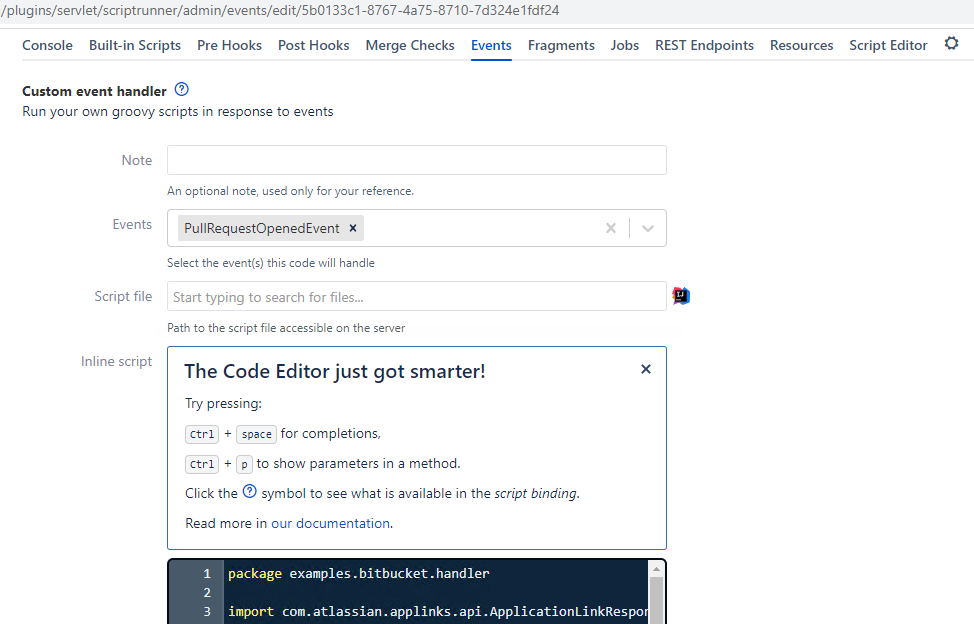

I am trying to get all linked tasks when pull request is opened:
Let me explain what I mean. For example, I have:
- two projects - "Project_A" and "Project_B".
- one issue of "Project_A" such as "project_A_issue_1" and 4 issues of "Project_B" such as "project_B_issue_1" and "project_B_issue_2", "project_B_issue_3" and "project_B_issue_4"
And I am creating a pull request of issues "Project_B" such as "project_B_issue_3" and "project_B_issue_4". The issue "project_B_issue_3" has links to issues:
- "project_A_issue_1"
- "project_B_issue_1" and "project_B_issue_2"
What I want is when pull request is created, then I need to read all these issues such as "project_A_issue_1", "project_B_issue_1" and "project_B_issue_2" in custom event handler "PullRequestOpenedEvent".
So I've borrowed code from here and adapted it to create task in Jira. Tasks are created perfectly.
How can all these issues ("project_A_issue_1", "project_B_issue_1" and "project_B_issue_2") can be read in these piece of code?
