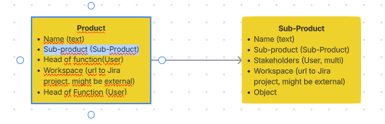

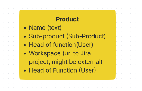

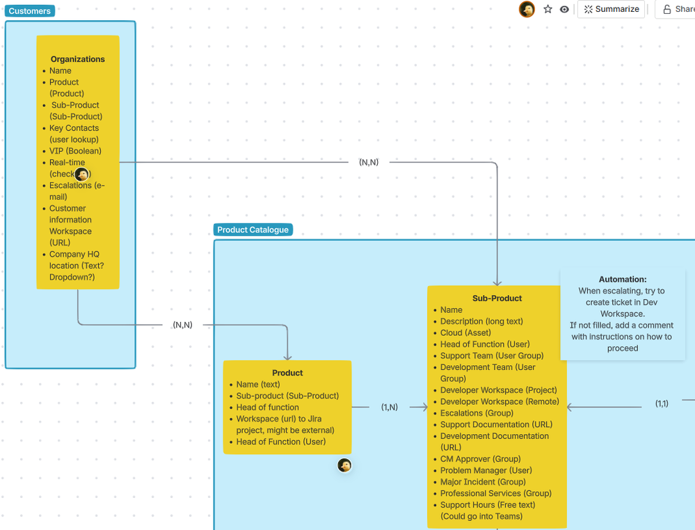

  •  Object types are boxes. I like to use "Rectangles" colored in yellow. Write the name of the Object Type in bold and list the attributes as a bullet list. Notice how I write the attribute type by the name. As a general recommendation, let the first attribute be the object type label. Also, if you reference another object, use the object type name as the attribute type.
  • Whenever your objects are related, create arrows between them: The rule goes as follows: The object that contains the related object has an arrow outgoing towards the referenced object.relation between products.png

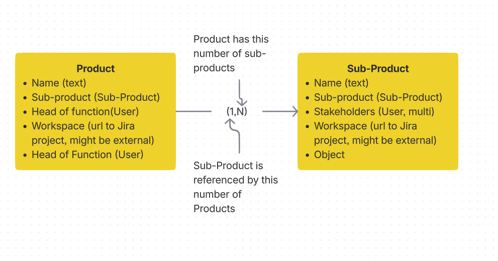

  • Use the relation to specify the cardinality. For example, my Main Product can have any number  (N) of sub-products, yet the Sub-Product may only be referenced by one Product at a time (1)cardinality.png

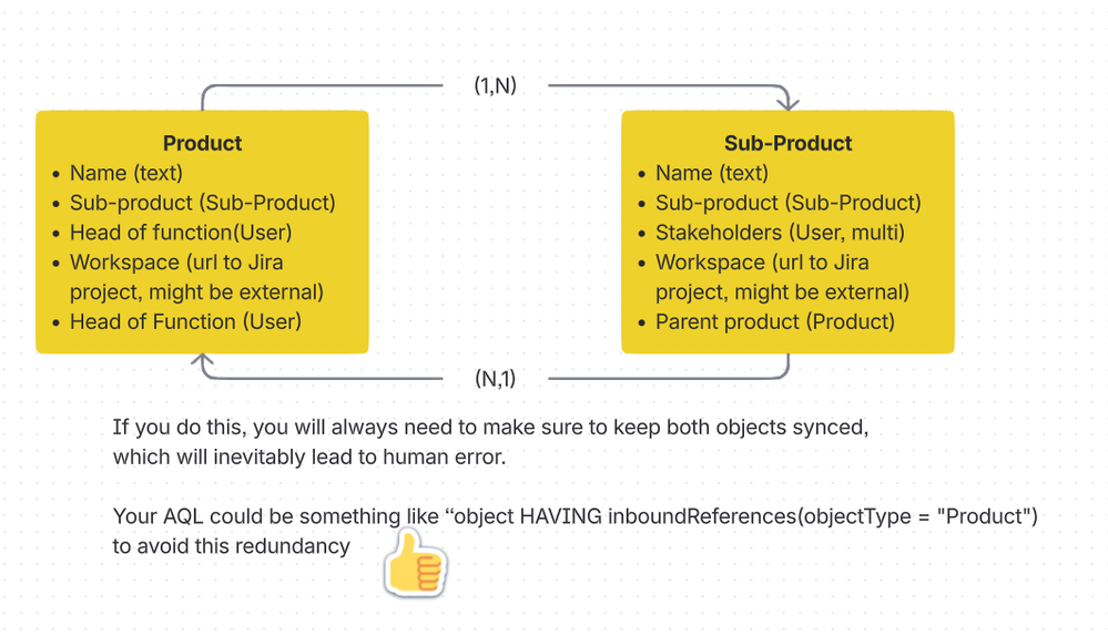

  • Avoid crossed relations. You might be tempted to keep in a subordinate entity the exact objects it is subordinate to. This is not necessary, as you can use the relationships between objects both inwards and outwards. bad practice.png
  • Use sections to design your schemes. This is really comfortable as you can refit your section as you design the system without the need to redo all your work. Name the section the way your schemes will be named in the future.sections.png
  • Your Assets live in Jira, make sure to account for it. I like to color code my sticky notes with Automations, in blue, triggers in green, decitions made during the design in purple and others as they come up.sticky notes.png

A real example

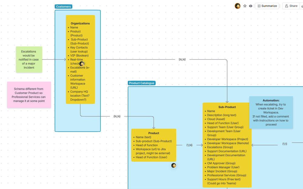

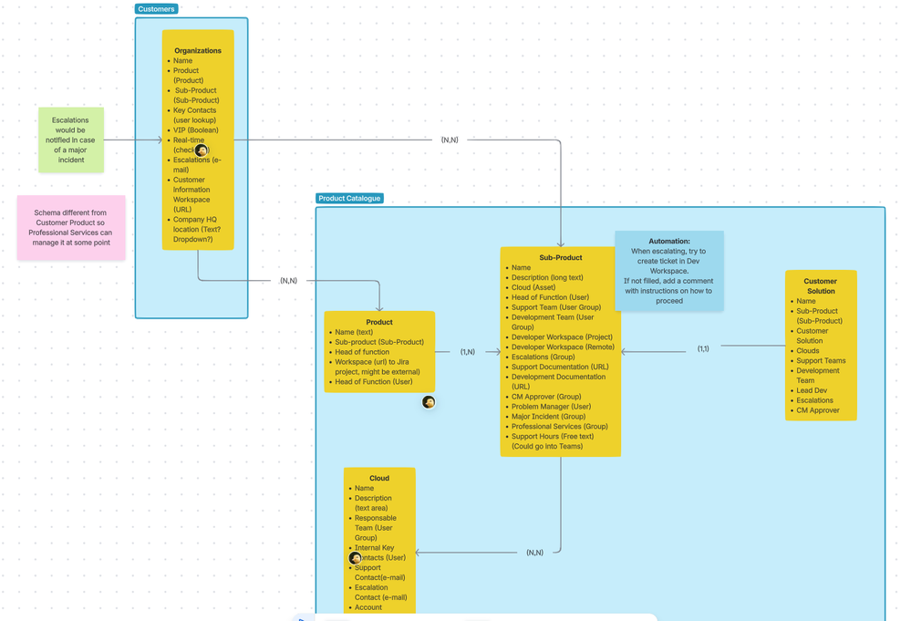

Recently I designed toguether with a colleague and a client a small database whose aim was:
  1. Keeping track of how many clients the company had
  2. Keeping track of the Products this customers had purchased
  3. Keeping a catalogue of Products and their modules.
  4. Cataloguing all their hosting, key stakeholders, support groups, etc for an ITSM service
  5. Automating assignments according to which customer opened tickets in JSM, as the routing could depend on which products they had purchased.
I might write another article outlining my best practices on designing Assets databases. This time around, let's just see the final diagram without zooming in. (Don't worry, I made sure to ask for permission before reposting this)
