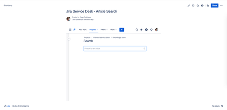

What we can do is embed the Jira article search page directly in Confluence with an iFrame.
Here is how we can do it:
  1. Create a new Confluence page
  2. Insert the iFrame macro in the newly created page
  3. In the URL field, insert the Jira Service Desk search page (it will look like this: https://mysite.atlassian.net/jira/servicedesk/projects/PROJECTKEY/knowledge/search?q=)
  4. Set the Width value as 100%
  5. Set the Height as desired (in my example I used 600px)
  6. Save de macro
  7. Publish the page
Users now should be able to search Jira from within Confluence by using the now embedded Jira Service Desk Article search page.
Using this method may inflict a penalty to page loading times. This happens because you will need to load two pages instead of just one.
