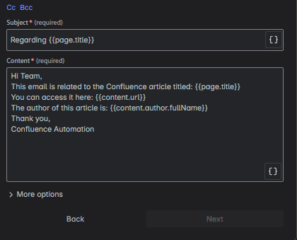

I have the following email set up to send with automation.
2025-06-30 13_18_44-Rule builder - Automation - DoTS IT Regulations - Confluence.png

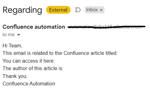

And the email being sent via automation works. But it comes across without any of the smart values as evidenced below.
What am I missing?

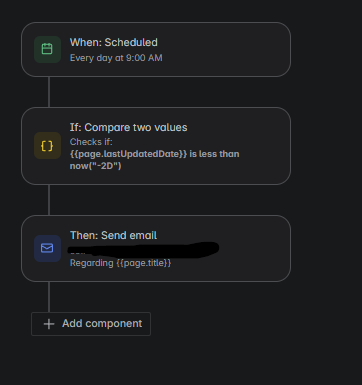

Collista Lewingdon
June 30, 2025
2025-06-30 13_52_14-Rule builder - Automation - DoTS IT Regulations - Confluence.png
Again, the only part of the rule not working are the smart values inside the email that goes out.

Trudy Claspill
June 30, 2025
How do you know it is working if the email content doesn't include any identifying information about the pages?
Can you explain the purpose of this rule?
It appears that you are trying to look for pages that have not been updated for more than 2 days and then send an email with information identifying that page.
If I have understood that correctly, then your rule is not constructed properly.
Disclaimer: I have not worked with Automation Rules in Confluence, so what follows is what I have gleaned from the documentation.

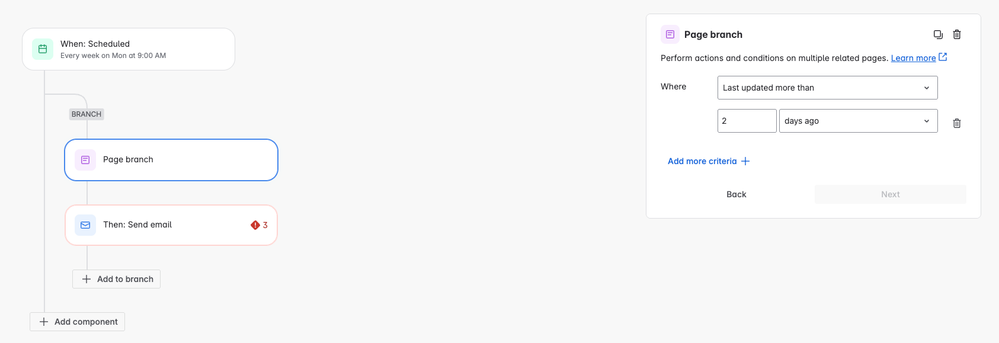

A Schedule trigger in confluence does not get the pages against which the rule will run. You need to use some component after the schedule to select the pages that you want. And an Advanced Compare is applicable only once you already have the page selected.
I blieve what you need after your Scheduled trigger is a For Page branch, with the Send Email action nested under the branch.
https://support.atlassian.com/cloud-automation/docs/branches-in-confluence-automation/#Page-branch

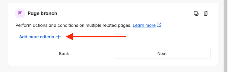

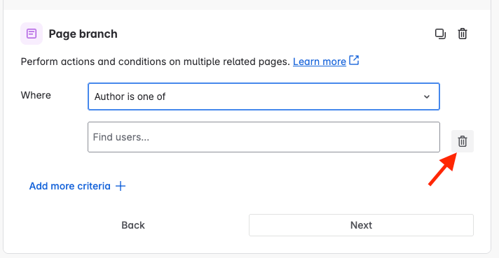

By default when you select the Page branch it will insert the criteria for Author. You have to click the trash can on the right to remove that.
Then you can click Add more criteria
