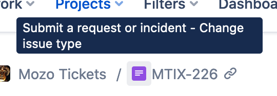

When I set the Issue Type to 'Submit a request or incident' (which is what requests submitted through the portal have as their type) then it all looks fine in the main JSM console but the users don't see their imported tickets - they can only see ones they have created through the portal.

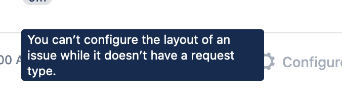

EDIT: now I'm not sure that these are even being imported correctly because JSM seems to be telling me contradictory things. Although I can see the Issue Type from the icon and the name displayed when I hover (see below), when I hover over the Configure cog below the More Fields box on the right, the message says 'You can't configure the layout of an issue while it doesn't have a request type'.

Screen Shot 2021-07-27 at 4.22.07 pm.pngScreen Shot 2021-07-27 at 4.38.01 pm.png

Thanks - I think I just about worked that out finally. My two screenshots show the type discrepancy but it's confused by the imported issue type getting the request type name during import (the importer let me pick that name)
I think perhaps you cannot import a request via CSV, only an issue. Do you know if this is the case? Seems mighty strange and makes migrating to JSM bizarrely difficult!
I'm now trying to change the imported issues into requests - don't know if that 's possible.

I tried that but couldn't make it work. However I did find a reference to the bulk edit wizard here and that enabled me to change the type from issue to request.
Problem solved but really? It's almost like Atlassian don't want people to migrate from another system to JSM. You can't import requests, only issues, and the only way to make the imported issues into requests is through following some obscure path only referenced in a comment in the community?
