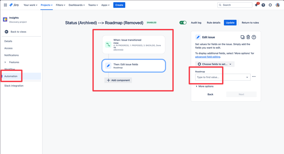

@Tomas Greif I did this yesterday actually, but for when we "archive" an idea. Here's a screenshot to do it with the out of the box automation. You just leave the "roadmap" field value blank.

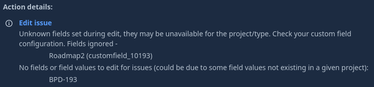

Thanks @Adam Sadowski . I get the same error as before. I have even tried to create my own custom field and then apply the rule. I still get the following:

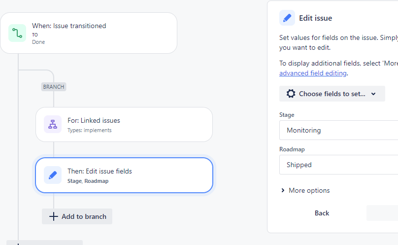

I do something similar, but different (so this may not be of interest to you but I thought I'd mention it).
Instead of removing the value from the roadmap field, I've defined a value Shipped that I use. (This is so that I can distinguish between ideas that have shipped and those that haven't yet made it onto the roadmap).
