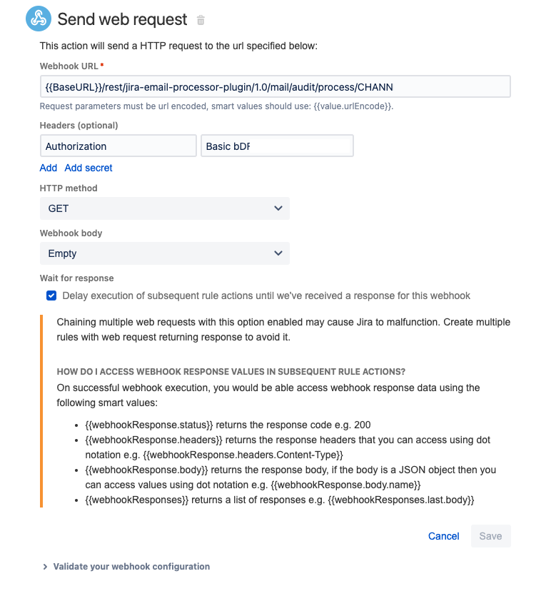

Hi @Mark B Wager
The API seems to work correctly. If I switch to another user that is not a project administrator or incognito mode, it fails.
I get this data from the API string.
{"data":[{"id":17234,"mailChannelId":11,"mailItemId":17234,"handlerName":"Service project Mail Handler","resultStatus":"FAILED","message":"Current user is not active","fromAddress":"inactiveuser@jira.nu","mailChannelName":"emailchannel@jira.nu","subject":"Sv: Radera domän","issueKey":"","noOfRetry":0,"updatedDateTime":"2024-11-28 09:34","createdDateTime":"2024-11-28 09:34"},{"id":17227,"mailChannelId":11,"mailItemId":17227,"handlerName":"Service project Mail Handler","resultStatus":"FAILED","message":"Current user is not active","fromAddress":"inactiveuser@jira.nu","mailChannelName":"emailchannel@jira.nu","subject":"Radera domän","issueKey":"","noOfRetry":0,"updatedDateTime":"2024-11-28 06:27","createdDateTime":"2024-11-28 06:27"}],"totalPages":1}
I attached an image for the web request settings.
Mark B Wager
December 9, 2024
Hi Tobias,
If the API works then your command is correct. So, the issue must be 'permission' related, since you mention switching to another user.
The API authentication token you use represents the "user". So, to access the project and it's settings, you need to make sure the user has proper access in the project. They'll need a JSM license, be a role member, and have permissions that allow them the access (e.g., Project Admin). I can't remember if they need to actually be a Jira admin. I don't think so.
We created a special service account and use this for the user. This way we can assign access that is separate from our admins, for tracking and so things don't break when people change roles or leave the company.
Does this work if you create and use your own API key?  You might want to create a test user and create an API key for it and try it with that.  It sounds like you have things right, but just need to work out the user permissions, as described above.
Mark

@Mark B Wager
Does this article apply to Jira data center, or is it just for Jira cloud?
I've tried with my own user (global Jira administrator) and API key, and the automation still keeps failing. If I paste the URL into my browser, it returns the correct data.
If I switch to Bearer instead of Basic and my access token, the automation "succeeds", but the webhook returns no data (I tried changing from true to false) and the e-mail that got sent was empty.
tobias December 10, 2024
@Mark B Wager
We finally got everything to work
* We switched to using Bearer instead of Basic
* Instead of API key, we are using Personal Access Tokens
* "webhookResponse" instead of "webResponse"
Thank you for your help!

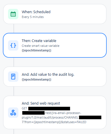

Cyril January 27, 2025
Hi @Mark B Wager
thank you for your feedback.
I did create the variable (and added a log to be sure it was correct when I saw it was failing)
Whatever the smart value in the variable, it always fail. (I have tried a lot, including the ones proposed in this thread)
below the automation
I really don't understand what I am doing wrong...
thx
Cyril.

Hi @Cyril can you post the screenshot of the smart value you're filling the variable with, as shown in the main post?
Hi @Mark B Wager ,
I found the issue - the time was not turning into a real epochtime, but still having a formated date
I found out by re-writing the variable instead of using copy-paste (maybe an hidden character somewhere)
before (not working)
Log (of the variable)
2025-01-27T13:15:25.8+0000
after (working)
1737952829520
All good now !
Sorry for the disturbance and thank you for the assistance
best
Cyril.
