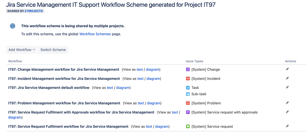

  1. From your project, go to project settings, then workflows;
  2. Select the workflow from the issue type you want to change and click on Edit under the Actions column;

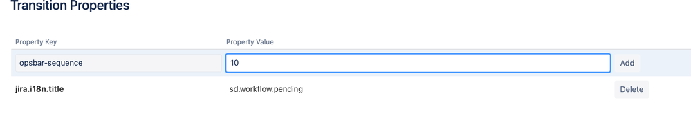

  4. In the transition properties screen, add the opsbar-sequence in the Property Key column, and the numerical value in the Property Value column and Add;

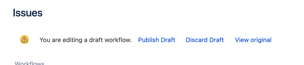

  5. Go back to the workflow screen and publish your draft workflow after you make the change to all the transitions needed.

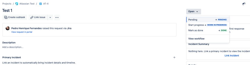

Example before editing the transition:
Example after editing the transition:

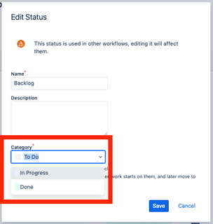

When I say "category" I mean the Jira categories ("To Do", "In Progress", and "Done") for the statuses:

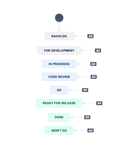

All of our statuses have a global transition, meaning that any status can transition into any other status.
Regardless of which statuses I add the opsbar-sequence property to (all or just some), it doesn't reorder the statues in our issues view. You'll notice that "In Progress" comes after "Code Review" which is not the order we want. Same with "Done".
