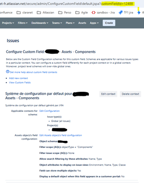

Custom field 12488 is an asset object

I see you're trying to use placeholders within the query in automation. However, within automation you might want to try using smart values.
In your example, that would mean replacing
name = ${customfield_12488.value}
with something like
name = {{customfield_12488.name}}
Other part of the query also seems to be missing one opening parenthesis, specifically when it comes to the part after "classe" attribute.
As for testing AQL, I would suggest navigating to a particular Assets schema and then using Filter > Advanced AQL option to search of issues. Here, I usually 'hardcode' all values just to see if all operators and queries in general work as expected.
After that, I replace those hardcoded values with smart values (when it comes to automation) and test that out.
Also, when it comes to smart values, I would suggest using Log action within the rule to see what you'll get as a return from specified smart values.
