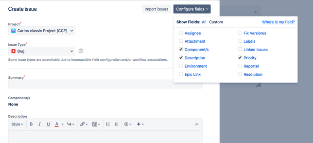

You can try the 'where is my field' functionality to find out why the field may not be showing in the screen:

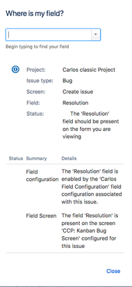

In my example above resolution is displayed for the Bug issue type and the 'where is my field report' says:
You should check the field configuration and the field screen to make sure that the field is enabled there. For the field screen you may have to do the following:

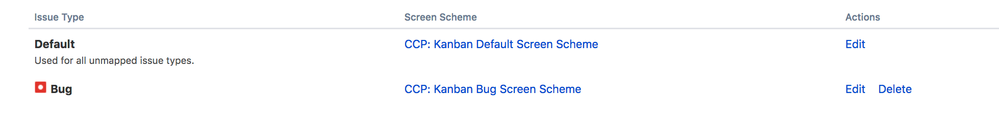

Click 'Configure', select the issue type (e.g. Bug), and verify the screen scheme used for the issue type (e.g. 'CCP: Kanban Bug Screen Scheme):

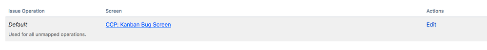

Click the screen scheme and check the screen for the issue operation that you need (view, edit or create, or default):
