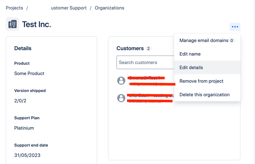

thanks for your feedback. This is exactly what I try to do. Let say I have the following organization in my project. I'm trying to get the values of the fields "Product", "Version..." etc...
Here is what I do:
* Retrieve the organization list using a GET on https://mydomain.atlassian.net/rest/servicedeskapi/organization
* then I pick the one in the image above (let's say ID=39) and request this organisation as follows: https://mydomain.atlassian.net/rest/servicedeskapi/organization/39
This returns: {"id":"39","name":"Test Inc.","_links":{"self":"https://mydomain..../organization/39"}}
Now, my understanding is that you can get the list of the organization detail fields (their keys, actually) using: https://mydomain.atlassian.net/rest/servicedeskapi/organization/39/property
But this does not return anything else but: {"keys":[]}
Whatever the organisation I'm trying...
