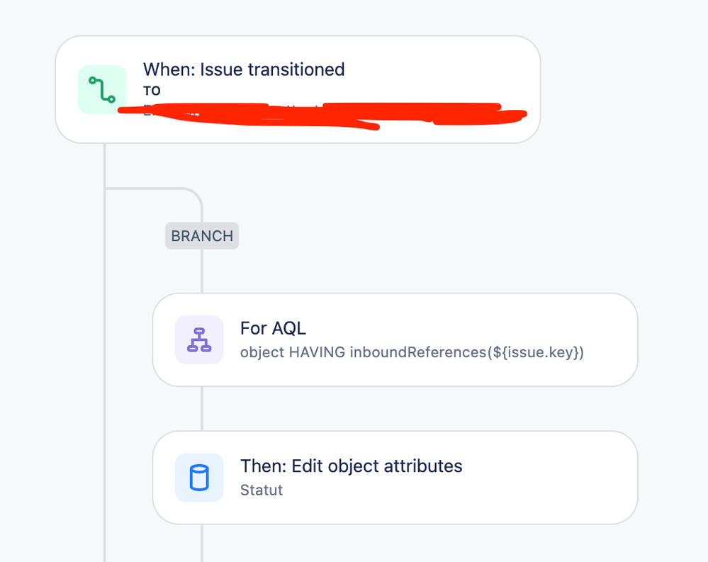

I want to make an automation that works this way :
1) An issue is transitioned to another status (for example, Waiting for answer).
2) The status attribute of an asset object filled in the Jira asset field Device is updated.
I tried this automation : Capture d’écran 2024-11-14 à 13.45.16.png
I think I do not quite understand the way AQL works because it does not seem to work.
Am I on the right way ? Do yoju have an idea of another AQL search to do that ?

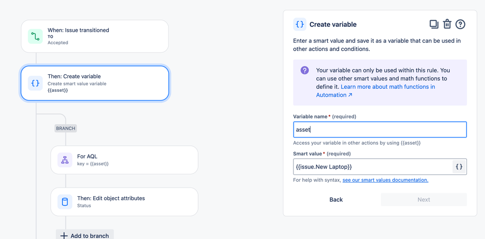

Hi @Flavien Gache
So you have a field "Device" that is of the type custom field assets, correct?
Then this automation example could workScreenshot 2024-11-14 at 15.47.14.png

Well, it seems to work perfectly. A simple yet elegant solution.
