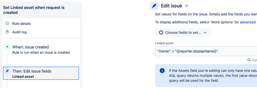

Correct, you have to do it using automation. Here is an example where the linked assets is populated with the reporter's assets when a request is created.

Use "Name" = {{issue.components.name}} instead, otherwise components would come back with the internal number instead of the display name. And to cover the situation where you have multiple components on the request you should use this one instead:
"Name" in ({{issue.components.name}})
Thank you Mikael this is right on. I just added a print statement when you sent the note about adding the .name to the query. I had no idea that components were organized numerically and understand why assets would've missed the reference by being sent a number value. This gets me off and running. Do you have any recommended documentation?
