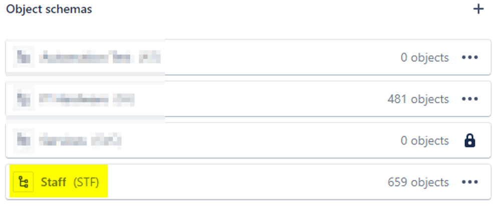

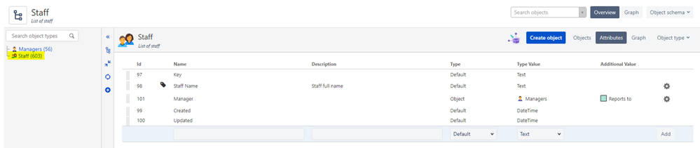

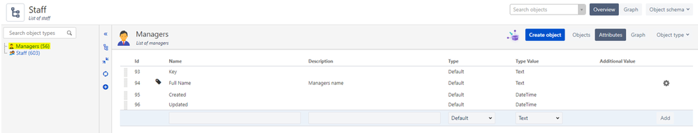

Hi, our company is now investing time on the Assets module and I have been busy building Object Schemas / Object Types etc.
I have now got to the point where I am trying pull through a value from Assets to display on my Issue Ticket, and this is where I am getting stuck / confused....
This is what I have: (see attached screenshots)
Object Schema
  • Staff
Object Types
  • Staff
  • Managers
Object Attributes
  • Staff
  • Managers

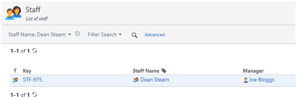

What I am trying to achieve is for the 'Manager' name to be pulled through to the ticket based on the name of the Reporter that raised the ticket.
For Example:
I raised the ticket so I am the reporter - Dean Stearn
In the Staff list, Dean Stearn has a manager named Joe Bloggs, so I want a field on the ticket for Manager to be visible that shows Joe Bloggs.

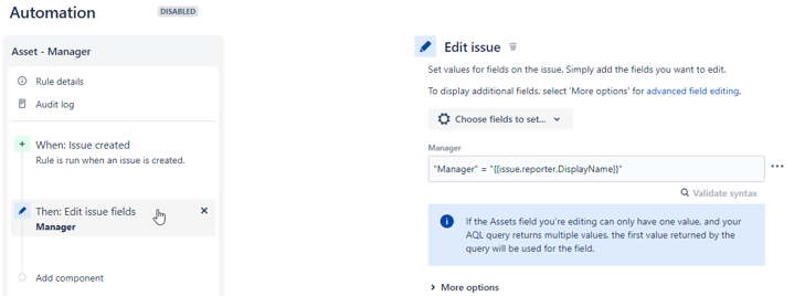

What I have done so far:

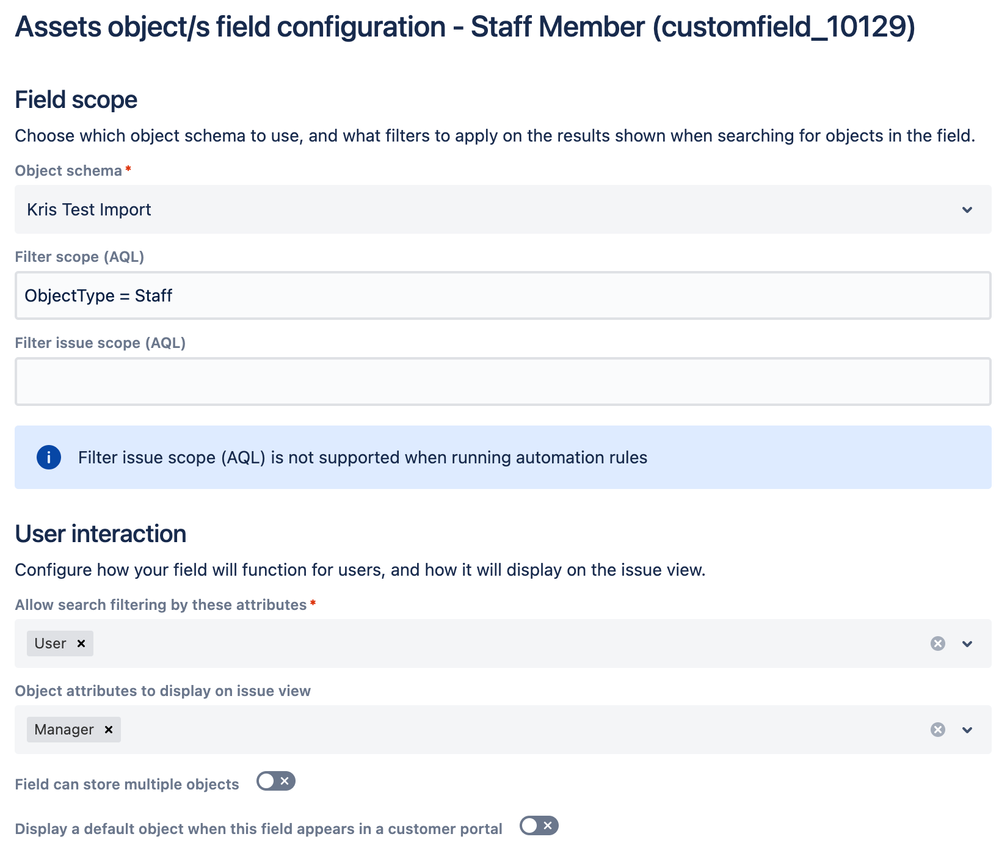

I have created a custom field (Assets Object field) that appears on my ticket.
I believe an automation rule is also required, so I have set one up that triggers when any issue is created.
This is how far I am getting and not getting the results as I expect.
Can somebody please show me where I am going wrong.

Hi @Dean Stearn ,
What are the results that you are seeing?
First of all, I see some strange things in your configuration. You have a custom field "Manager" that displays information from the 'Staff' object type (Filter scope AQL).
Instead of using "Full Name" for both "Manager" and "Staff" (Default text field), I would use the attribute type "User" to link directly to a user account.

My rationale for using the "Staff" object type for the filter scope AQL, is because the manager's name is displayed as an attribute on the "Staff" object type. This is where I am getting myself confused as I am not sure if the filter scope should be "Managers" instead.
Your suggestion about using the attribute type "User" instead of "Default", I don't follow what this does. When  I change the Type from Default to User, I then have to select something for Type Value. I was expecting to see a list of users, but instead I see User Groups.
Should I just select a user group for the Type Value?

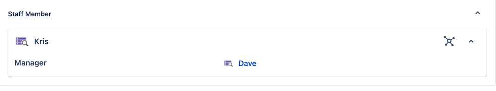

Kris Dewachter
February 26, 2023
Hi @Dean Stearn ,
You will still have to link the "Issue" with the Asset Object via a Custom Field.
You can create a Custom Field "Staff" that pulls the data from the Assets.
To populate the field, you can make it visible on the screen, or automatically fill it with an automation rule (probably the best solution).
When the field is populated, when you select the "Manager" attribute in the "Object attributes to display on issue view", you will see it on the issue detail screen when you open the details of the "Staff Member" details field.
Best regards,
Kris
Dean Stearn
February 26, 2023
Thank you @Kris Dewachter ,
I have now created a custom field and an automation rule and the details are pulling through as I would expect.
With a bit more experimentation, I hope to become more familiar with how it all works and start pulling some more useful information through to our issue view.
Thank you for all your assistance.
