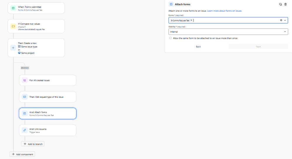

We have an automation where when specific checkboxes are selected within a request type form additional tickets are created.
I have this working properly but have just realized that when the form is attached to the newly created ticket it's attaching a brand new uncompleted form rather than the completed form from the original parent ticket. It is possible to do this?
Please see the automation being used:

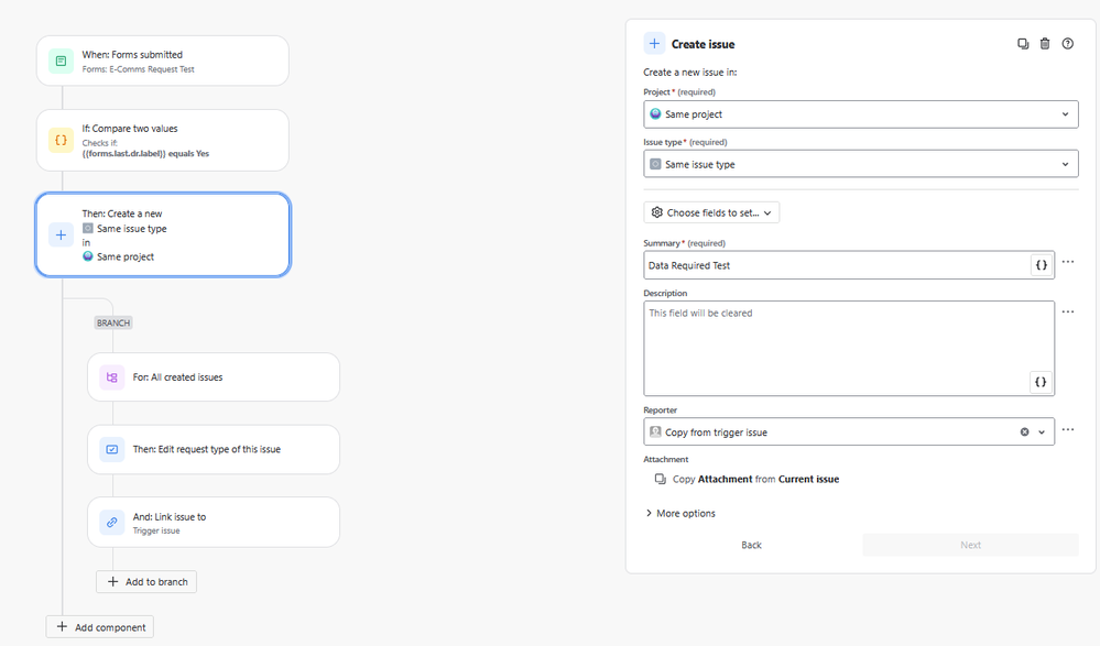

Please provide screen images of your current automation rule.
So within the original form from the top of the automation there is two checkboxes, if either of those checkboxes gets checked a new ticket is spawned (I have two identical automations, one for each checkbox)
I have turned on the option to turn that original form into a PDF and attach to the original ticket. Then within the Create a new I have it set to copy attachment from Current issue.
The problem being that within that original form there is also a section where the reporter attaches a document and this document gets added as an attachment to the original ticket, but even with Copy attachment from Current issue it's only copying the PDF attachment of the form and not the file that was also attached to the form.
