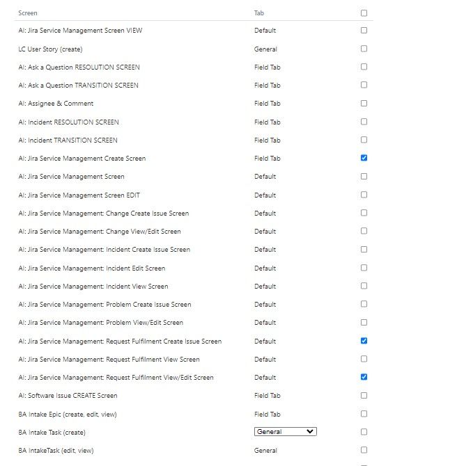

thorngje
July 8, 2022
Screenshot 2022-07-08 102626.jpgScreenshot 2022-07-08 102417.jpgScreenshot 2022-07-08 102316.jpg
thorngje
July 8, 2022
That is what I have set.  Is it because they are fields on a form?  Is this a limitation to API.  I have the fields link to Jira fields but when I do a GET t/rest/servicedeskapi/request/AI-xxx
I do NOT see the fields in the response.

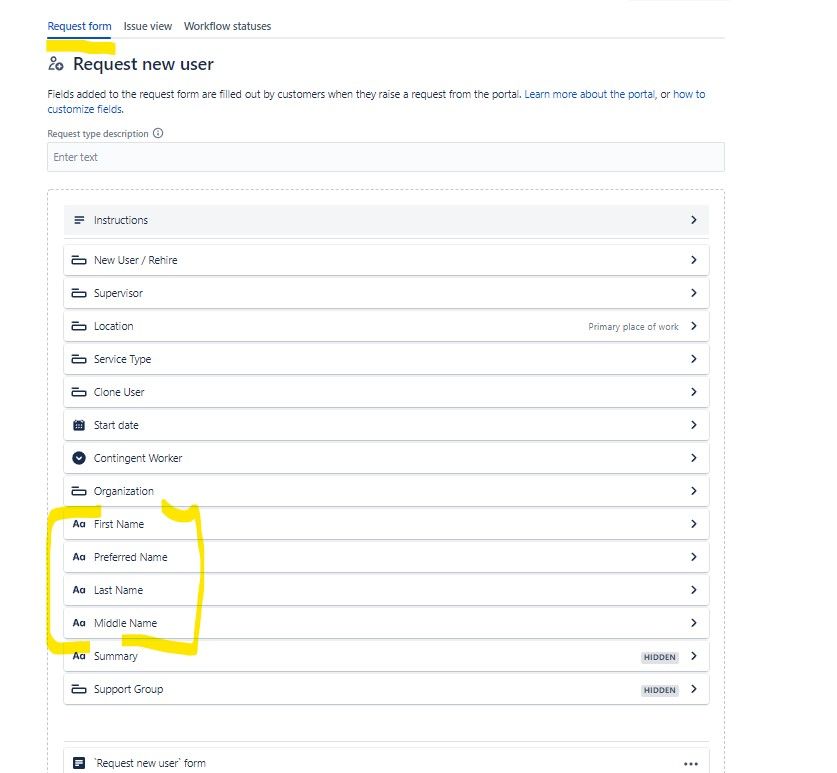

thorngje
July 11, 2022
I just happened to stumble across the answer to my problem.  I had the fields linked on the form.  Then I found out  was I had to add them to the Request form as well to fix my issue. Screenshot 2022-07-11 102301.jpg
