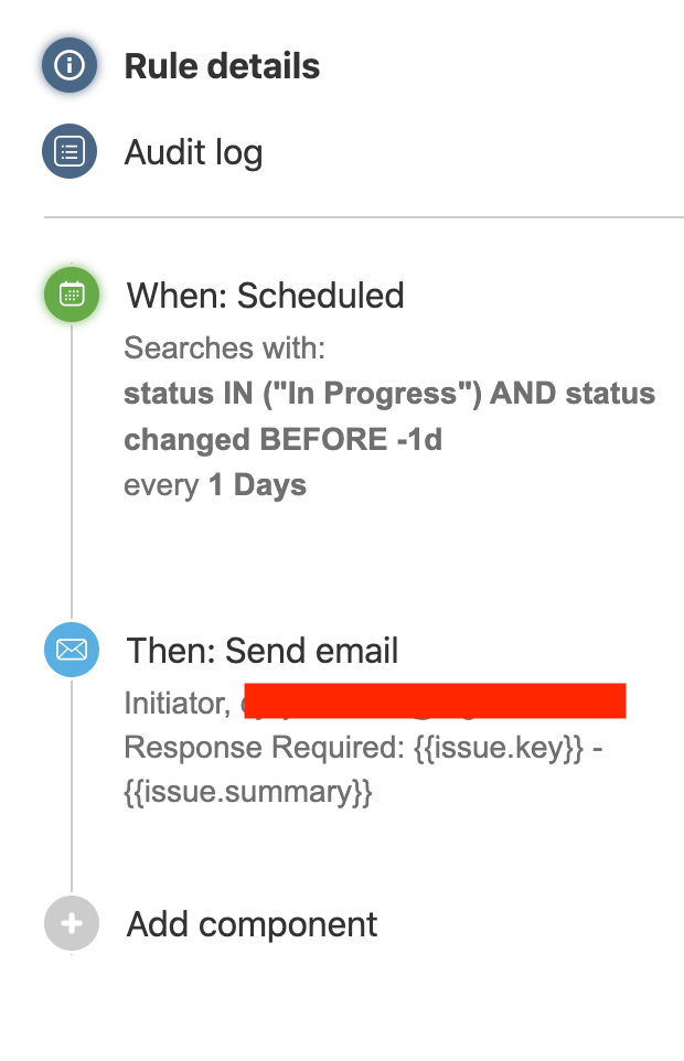

Hi @Sampath - Based upon steps 2 and 3, you'll need to change the trigger from Issue Created to scheduled.  You could do something like this:
  • TRIGGER: Scheduled (Daily) with following JQL
    • status IN ("In Progress", "Waiting for Reporter", "On Hold") AND status changed BEFORE -1d
  • ACTION: Send Email
    • Recipient: Reporter
    • Subject/Body: Whatever you want for step 4
This would address steps 1-4.  However, we'd need more information on steps 5 and 6.  If you're looking for something to happen after steps 1-4 have occurred and there's still no update, you'll probably want to split these into a separate rule.

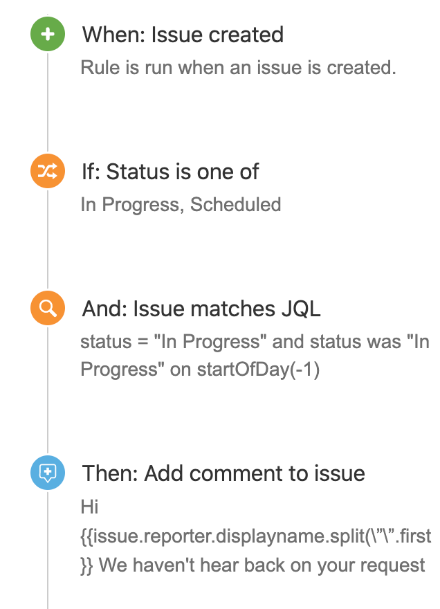

Sampath
August 2, 2022
Hi @Jack Brickey @Mark Segall
Thanks for your wonderful steps
I have tested upto step 4 . Validate the query . Issue found . But i didnt see it comment on the tickets which created 29/Jul/22
JQL Query : status = "In Progress" and status was "In Progress" on startOfDay(-1)
ADD Comment :
Hi {{issue.reporter.displayname.split(\”\”.first}}
We haven't hear back on your request . Please update the status
IT Agent

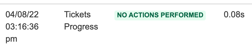

Jack Brickey
August 4, 2022
Can you please share an image of your rule and also the audit log from an execution where the comment isn't made but you believe should have been made?
Sampath
August 5, 2022
@Jack Brickey  Thanks for you response. Please find below details
Audit Logs
Action details:
Issue condition
The following issues passed: FHT-XXXX
JQL condition
The following issues did not match the condition: FHT-XXXX
Screenshot 2022-08-05 at 9.38.15 PM.pngScreenshot 2022-08-05 at 9.39.10 PM.png
Mark Segall
August 5, 2022
This rule will never execute because you're triggering on issue create and then setting a condition that it is in status x.  You probably need a when issue transitions or schedule trigger.

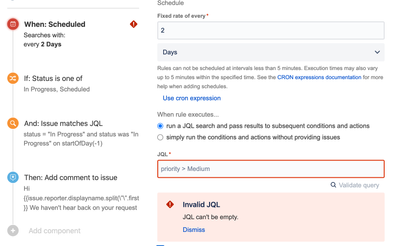

Hi @Mark Segall  Thanks for your response. Possible to share us exact rule
Mark Segall
August 8, 2022
Instead of the conditions, you would have the JQL in your schedule trigger.

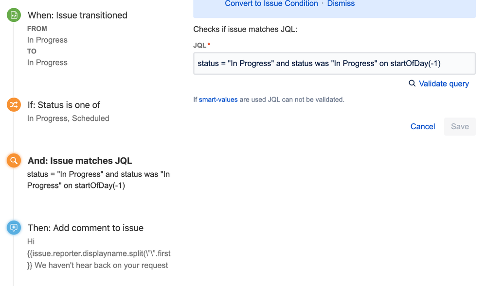

I have this rule, looks like validation not done @Mark Segall

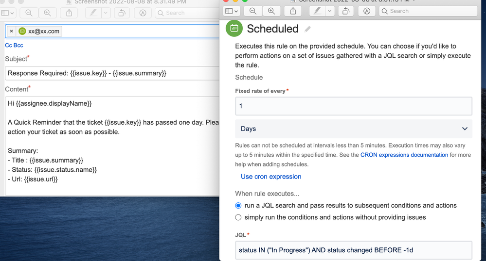

Mark Segall
August 8, 2022
Your trigger is set for "issue transitioned" and when issue transitions from In Progress to In Progress which means it will never trigger.  The trigger should be set to Schedule with one of the JQL queries that Jack or I shared.  Then you can eliminate your conditions.
Sampath
August 8, 2022
@Mark Segall  I have mentioned this in the rule any correction still? not sure . I have address the email id  Thanks
Mark Segall
August 8, 2022
This looks correct.  Can you share the latest screenshot of your rule along with the audit log?

Mark Segall
August 8, 2022
Here i need to create new ticket and check for tomorrow or it will take previous issue "in progress" status as well.

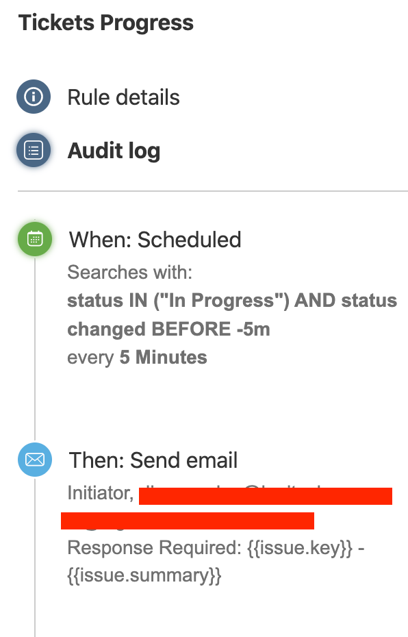

When you set a rule to run on a schedule, you'll have an option to "Run Now" on the top right of the rule so that you don't have to wait until tomorrow.
As for testing, If you don't have a test issue that's been IN PROGRESS for more than a day, you could change the JQL from -1d to -5m for testing purposes and then change it back once you're confident with the results.

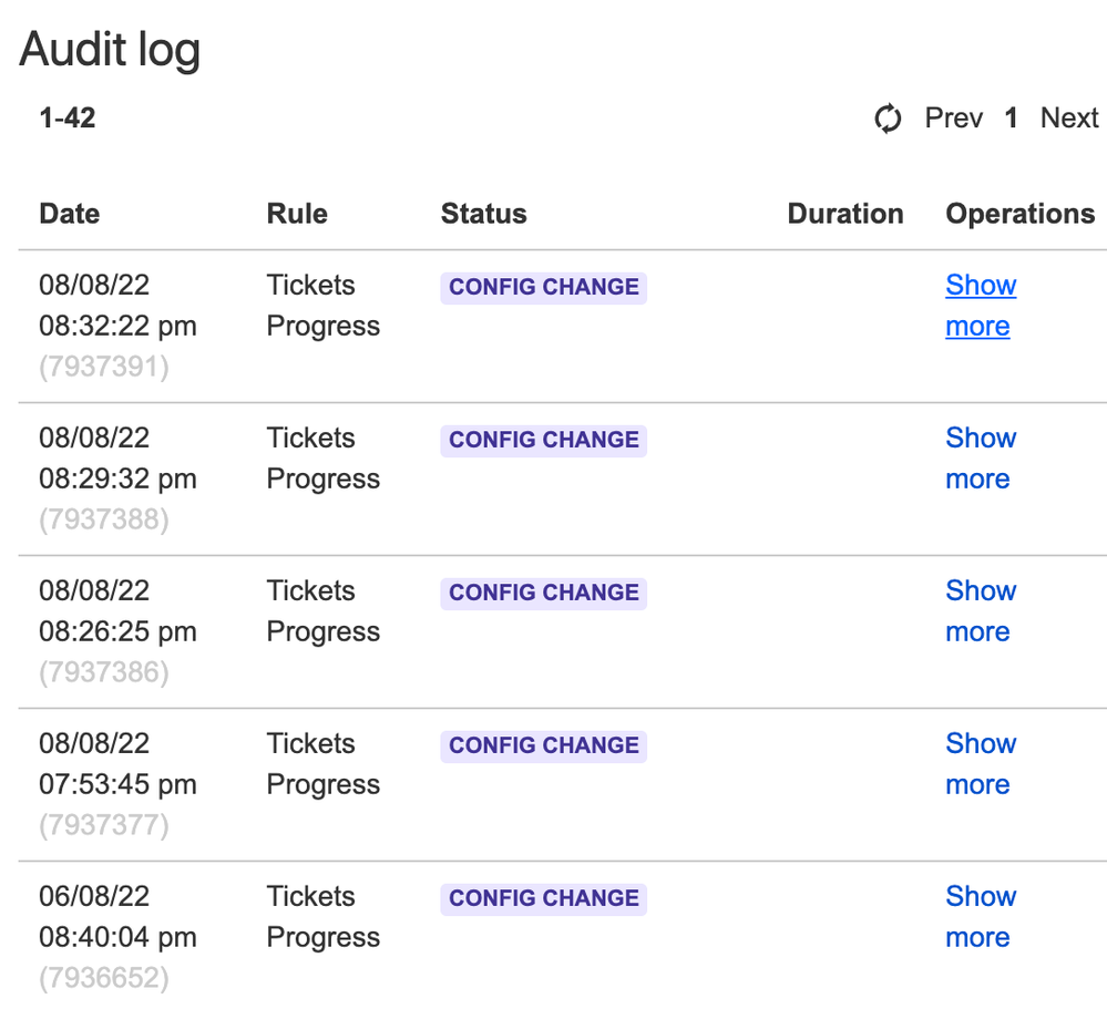

Sampath
August 8, 2022
Screenshot 2022-08-08 at 9.26.05 PM.pngScreenshot 2022-08-08 at 9.28.06 PM.pngScreenshot 2022-08-08 at 9.29.10 PM.png

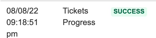

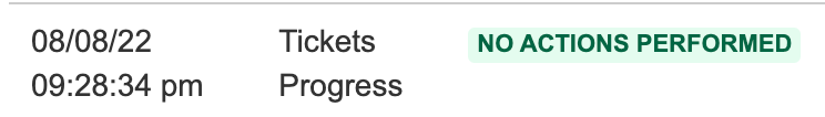

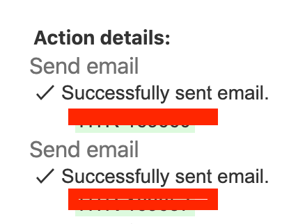

@Mark Segall  Thanks for your wonderful guidance. But here i am unsure it shows success few tickets but i didnt received mail so far. 09:18 Success but 09:28 No action it shows
Sampath
August 8, 2022
Hi @Mark Segall
Now it shows Success & schedule for tickets but email didnt received so far not sure in UAT authorized my mail id
Sampath
August 8, 2022
