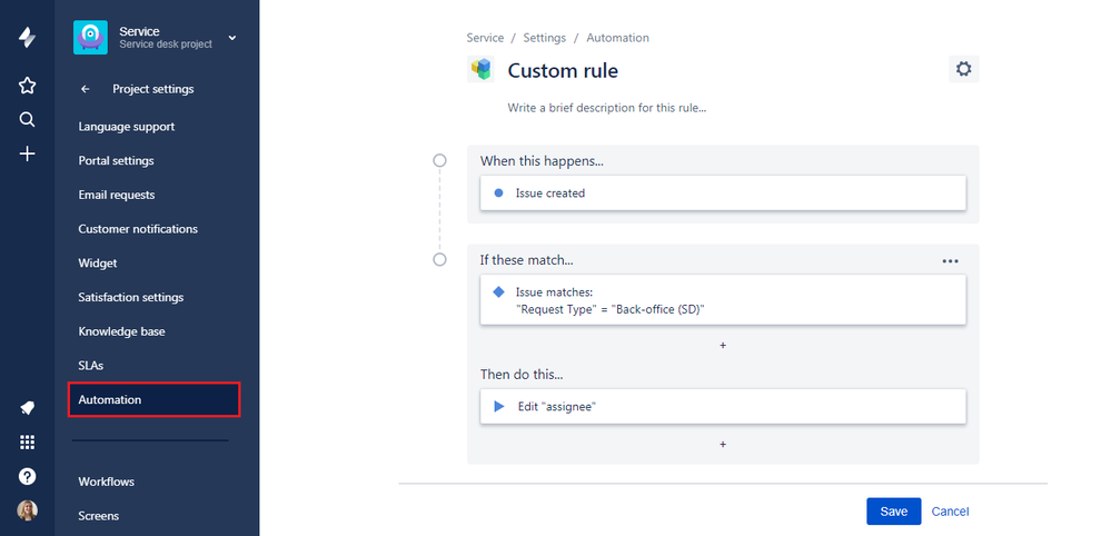

@Raynard Rhodes automation suggestion is right and you have an automation feature embedded with Jira Service Desk! Go to Project settings > Automation and add a custom rule:

That's good catch. I used Issue Type instead of Request Type.
Ah, indeed! I read too quickly and because of "Back office requests" I thought you used request type :)

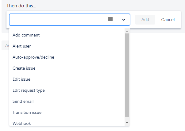

Cool, I am trying to do this how however when doing the "Then Do This" I can not add or set it to "Edit "assignee" any ideas on why I can not set that?
Can you provide a screenshot of what you see?

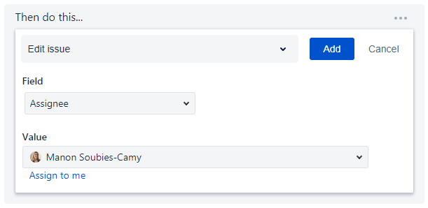

The option "EDIT ISSUE" is in the middle. Select that one and from there you will be able to select the field, which will be "Assignee"
Figures it was something simple and I was just not paying attention. Thanks. Going to test this out!
Thank you both! That worked on getting it to work!
