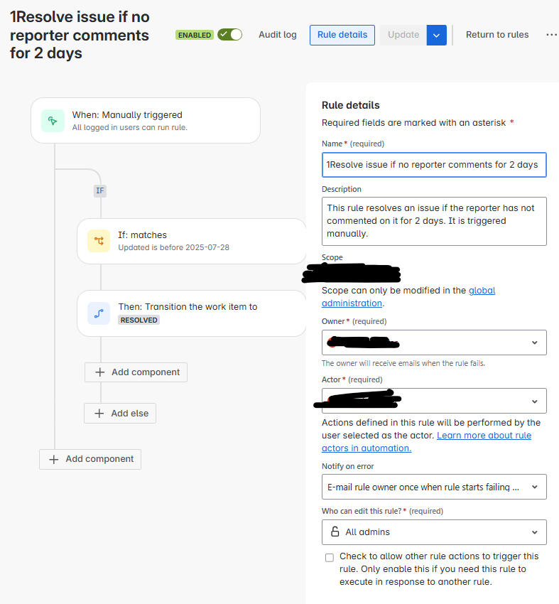

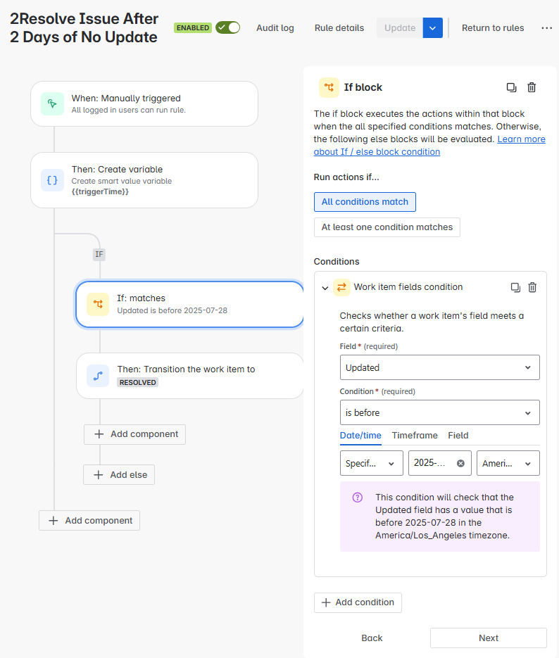

Need to create a manual trigger rule where the status will be changed to Resolved if there are no updates/comments for 2 days after the rule is triggered.
I started 2 variations but need some advice.

@Jennifer Bader -
Here is a condition that you can try -
{{issue.updated}} is less than {{now.minusDays(2)}}
It should work - try it out while writing into the audit log using Log action action/
I also agreed with @Dan Breyen suggestion.
Hope this helps.
Best, Joseph Chung Yin

So your examples will not trigger later. They are triggering now, and there is nothing to trigger that re-evaluation later on you are looking for, so what you want to happen has a bit of a fundamental flaw in that the technology doesn't operate that way. It has no way of being activated, then "waiting" or counting up and checking again.
Question: are these standard Jira projects (formerly known as jira software and jira work management), or are they in Jira Service Management (JSM)? JSM has some more tools that might work a little more elegantly for following up on items, but there are still options in regular Jira - we may just need to set up a daily scheduled automation to check things.
Also, if you have more information on what is driving the need for this automation, that might help as well.

This will be for JSM. If I use the TriggerTime could it could that as the start and then wait 2 days?
This would be used for cases where a user reports an issue to IT but does not respond to follow-up questions, and IT would want to manually click the trigger automation to close the ticket after 2 days.
